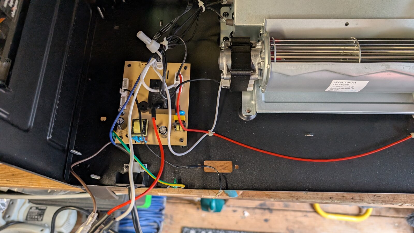

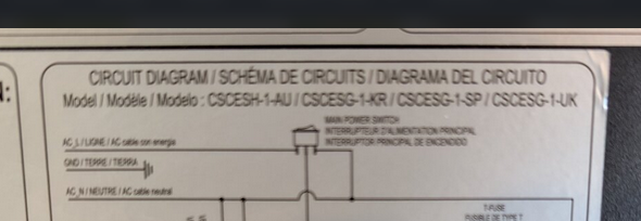

I bought an electric fan heater (stove style) from an auction, and it's brand new but has a fault where the thermal cut off kicks in as soon as the heating elements get current applied to them. I've checked the PCB and all terminals and can't see any signs of blackened cables caused by overheating or a short, and I'm wondering if it's the thermal cut off fuse or the heating elements themselves (there are 3 x of them).
The heater itself is £150 RRP but I only paid £10 at the auctions so I'm not overly bothered if it's knackered, but I suspect it's a simple fault that can be repaired. Not sure if you can help, but any advice would be greatly appreciated.

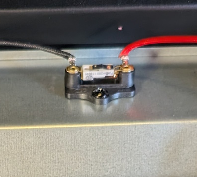

The fan starts and runs OK, and after about 5 x seconds I hear a clicking noise and at that point the fire heating control gives off a beeping noise, and the fan runs for about another 30 x seconds and then shuts down. There is never any heat produced.
I did wonder if this is the thermal cut off switch, seen similar units on toasters I've repaired - perhaps needs replaced?
I'm wondering if the tangential fan and motor bearings are a tad tight and the heat is too much for the TCO before the fan has wound itself fully up to speed. It couldn't hurt to strip and lubricate so as to be sure.

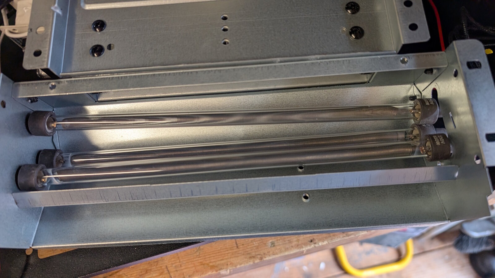

Speculatively, looking at the glass envelope on the heating elements, these appear to be a quartz glass IR elements.
Do they start to glow red, before the cut-out (if it is that) operates?
I may be wrong, but if this was set to the lowest heat setting with a single 500W element, I doubt an over heat cut-out would operate so quickly, even if the fan was operating sub-optimally.

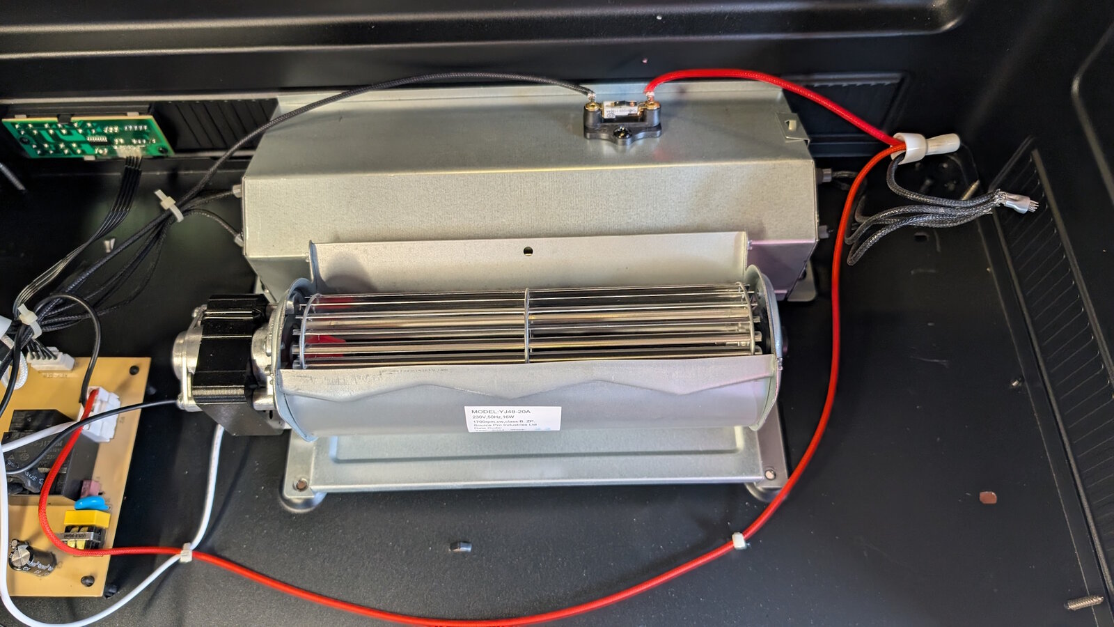

Is this happening with any covers missing? I'm wondering if insufficient air flow to remove the heat.
EDIT reading again I see no heat produced is there any chance the airflow is blocked? (from the pics it doesn't appear to be).
Also I see that crooked element, I doubt it makes any difference but I wouldn't expect to see it like that.
According to the book of words, it's designed for 100 to 120 volts, so there sits your problem.

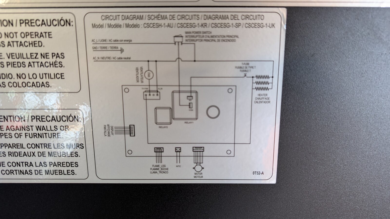

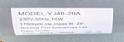

I'm a bit confused, and wonder whether the book of words you're looking at is the appropriate one for the OP's heater, because ...
... although I'm not sure what the "16W" (if that's what is says!) is all about!
That model number, on the label, traces to what appears to be the fan motor. Likely the heater model will be on a label on the outer case of the heater.
I got the model from the circuit diagram photo
and found a generic manual, I ignored the voltage rating in said manual as
As Harry says the 16W relates to the fan assembly.
Are the IR elements not usually a dark colour?
I have seen similar looking elements in tumble driers.
