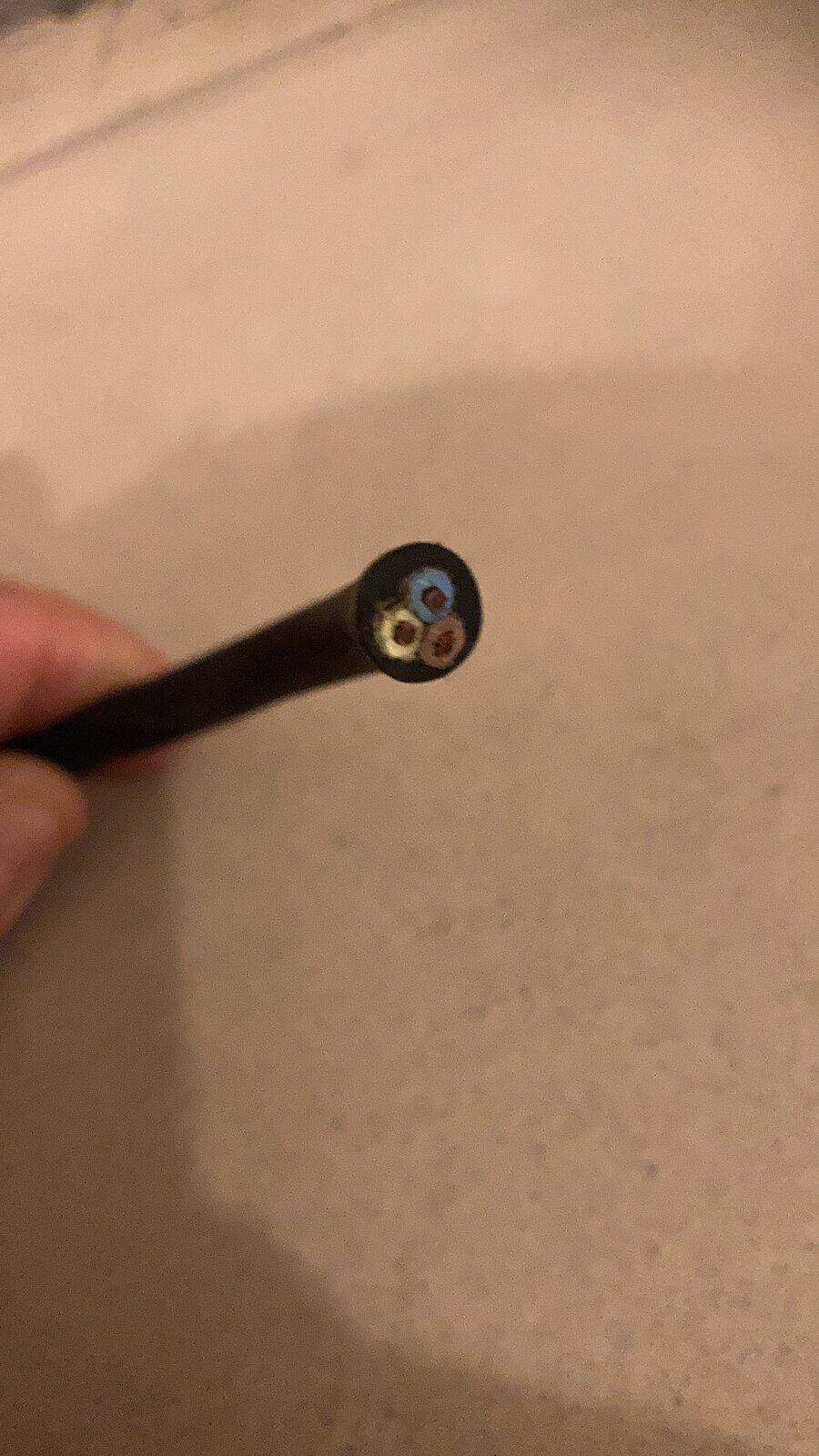

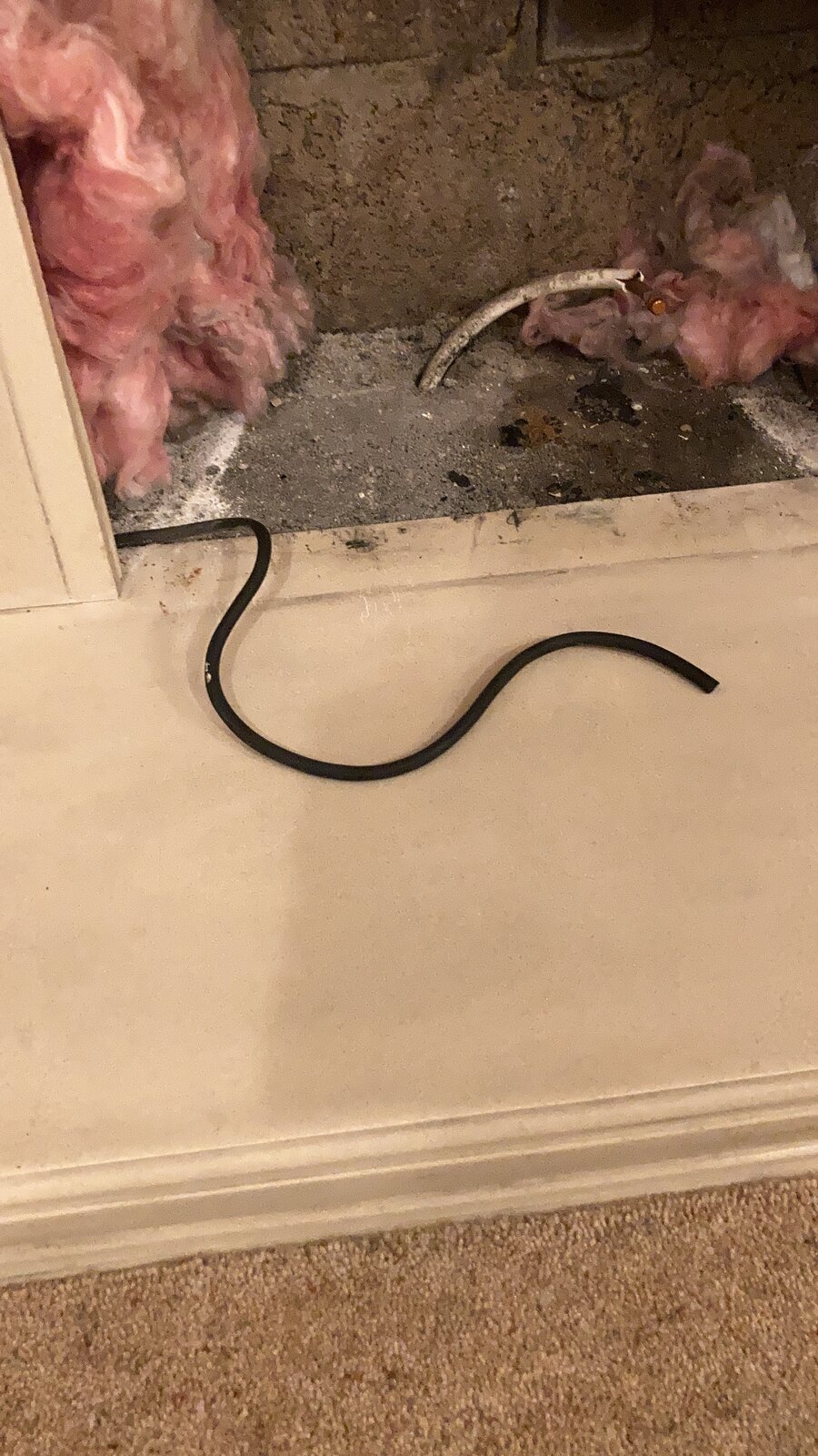

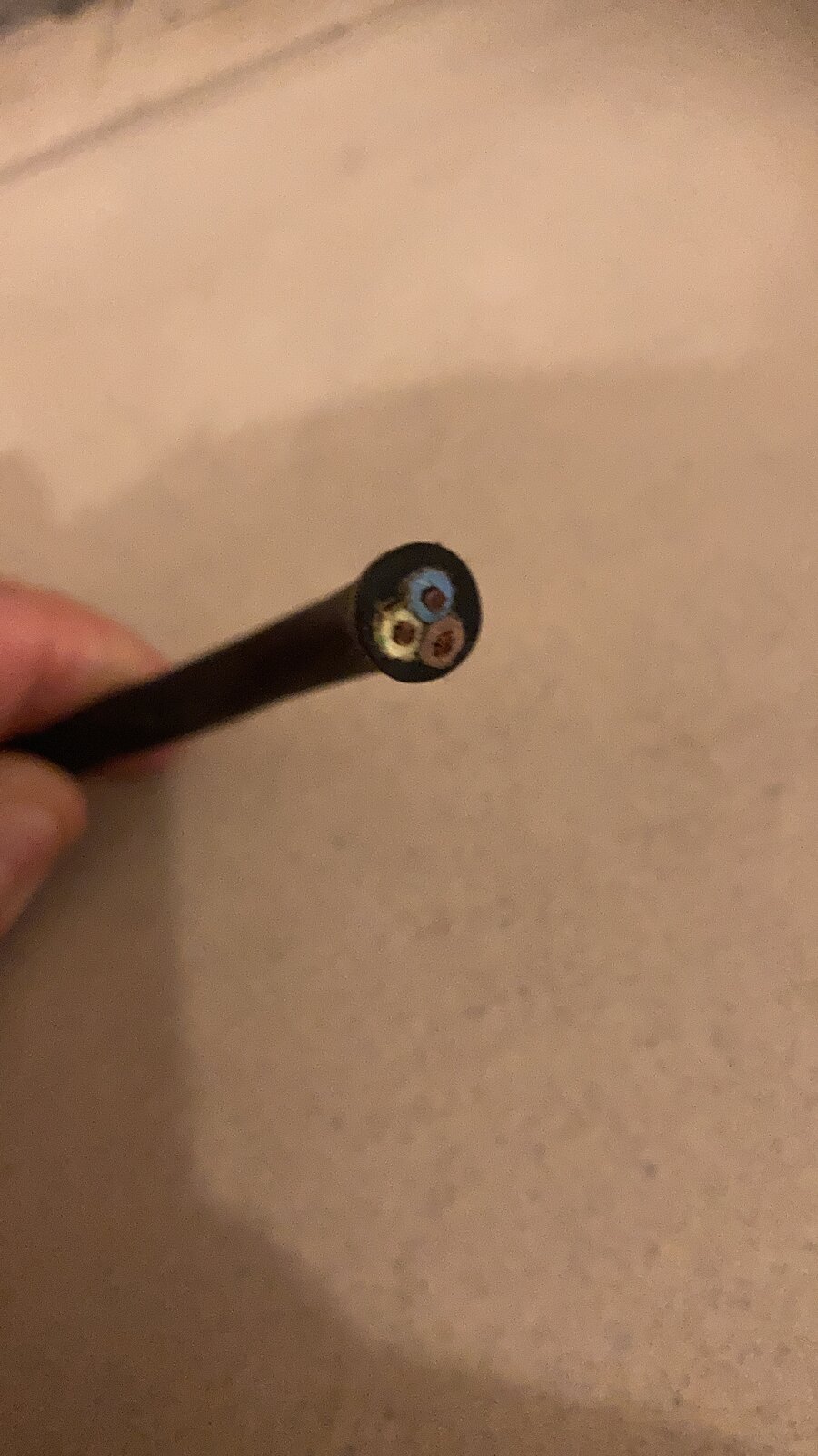

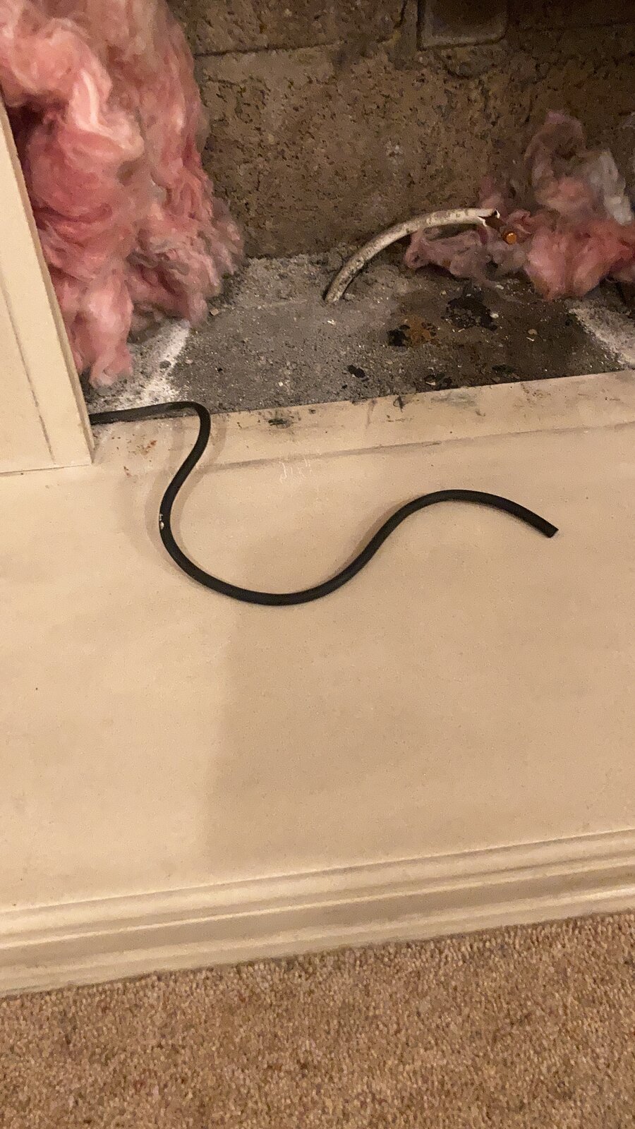

Thank you for your replies, I now have the fire and bought a socket to attach to the wire.
The wire I think has 1mm2 on it, does that sound thick enough? Pics below
The fuse in the socket outside the fire was a 3amp. I’ve been told I should get a 10amp for that, does that sound right?
Imm is rated around 2400w, for which a 10amp fuse would be OK. What is the rating of the new electric heater?

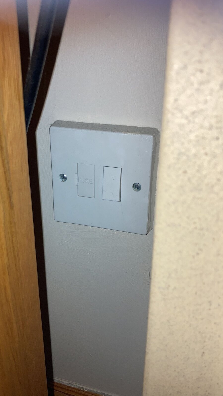

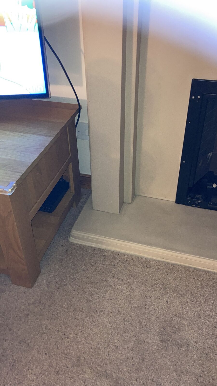

What is the 'switch', a photo might help identify it? Another thing we need to be sure of, is that the 'switch' is supplied via a power circuit.
Here is switch outside fireplace
