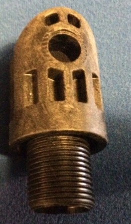

I have a electric recliner/riser chair, all is working ok accept the leg support and riser part.
Anyone know where i could find spare parts for these chairs.
The clevis is plastic and M20 fine thread. Screws into the end of the motor/actuator shaft lifting the chair/leg support
Maker of chair?
(Although some/all may use bought in parts).
Have you tried doing a Google Lens search on your image... it seems to throw up a remarkably similar part with a similar function on one result I've looked at.
Its a Sherbourne of some 20yrs passed down from parents.
Can only find one company with google, nothing with amazon etc
Have you asked the company if they can assist with parts?
https://www.sherborneupholstery.co.uk/our-partners/
Omega-motion supply the 'actions' and motors are TiMotion (where your part comes in, I think). Neither are likely to deal direct with the public.
You might ask some of the better mobility shops who sell similar items? Very similar actuators are used on hoists for wheelchairs and the like. Or just keep an eye out for units on freecycle etc.,. to salvage parts from?
