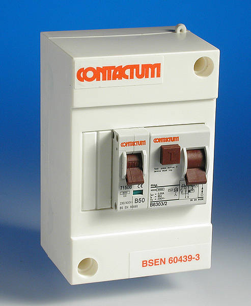

40A is OK for a 10mm cable, but a 40A load may be too high for your old CU, so it would be best to put in a separate one for the shower (or replace the old one completely, but that is more work).
For a separate one you want something like this:
but not that actual make - I just used that picture because all the alternatives on the TLC website show empty enclosures awaiting the fitment of RCDs & MCBs or RCBOs
You don't say if there is an RCD before the fuseboard, but if there isn't then that's another good reason to have a separate shower unit (and a good reason to replace the old fuseboard).
You'll need to feed the shower CU with tails via a service connection block (aka Henley block) - this is basically a big high-current junction box which joins the tails from the meter to other tails going off to multiple CUs. If your installation does not have an isolation switch the only way to interrupt the power will be to pull the main service fuse, and whilst many people feel that this is a safe and easy thing to do, I can't advise you to do that yourself.
