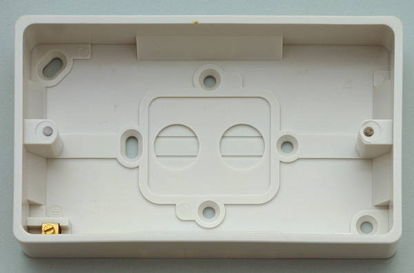

Electric socket back boxes
Those plates with extra lugs may be designed to fit into specific boxes for use with dado trunking.
For normal boxes, get different plates.
Or (assuming you've already bought or acquired the faceplates) hacksaw or cutters will do the job (cutters will work fine as long as those faceplates are softish slightly flexible plastic- if they're the very hard rigid plastic then hacksaw will reduce chance of the things cracking
They look like excel faceplates. The plastic tags fit their own surface boxes. You can use metal flush ones, and if the boxes are not below the surface of the wall a little, snip the plastic tags off. Side cutters and a twisting action. Job done.

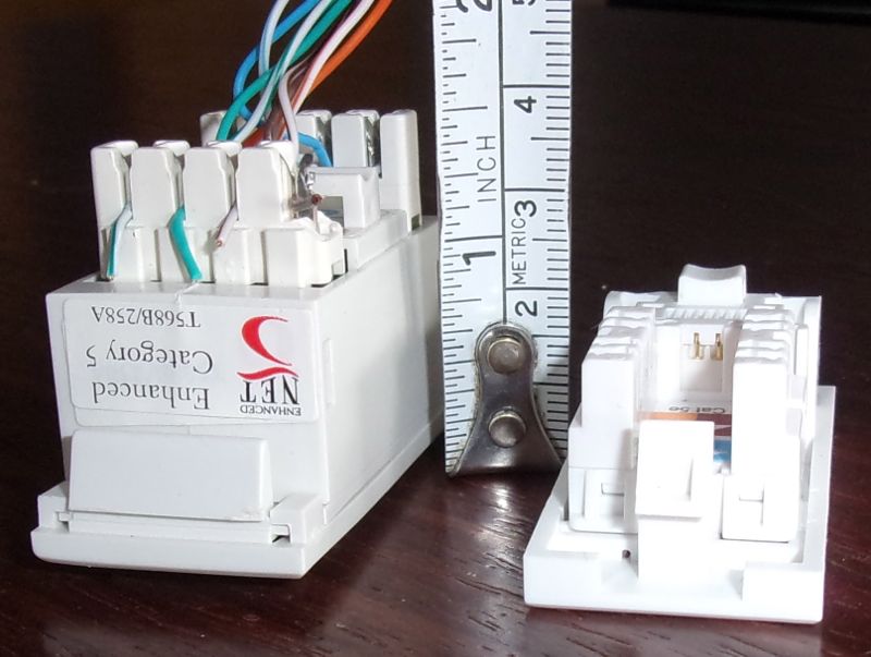

You'll need to check the depth requirements, as without the extra depth from having the bevelled faceplate move the sockets outwards, you may need a deeper box.
What the manufacturers won't tell you is that any Euromod module should fit any Euromod faceplate (that's the whole idea of the Euromod system, and the LJ6C standard) - they would rather sell you everything and make more profit.
They don't always fit.
The Excel ones were developed slightly deeper to allow the use of standard 25mm back boxes, including flush, surface and dado. The requirement for structured wiring is 35mm behind I believe.
That's why I said you need to check the depth requirements. At work I've been using some from Connectix that are really low profile - I reckon those would fit a 25mm box with any plate.
I've been putting 35mm boxes in for the data & AV stuff at home. Would normally use 47mm boxes, but with brick that makes 'kin 'ard bricks seem like soft cheese, there was no way I was going to try and chase that deep.
So are we saying that 25mm back boxes aren't usually deep enough for ethernet faceplates, but the bevelled type should be ok? They won't really be see as I'm locating them behind the TV etc.
It really depends on the socket modules. Some are really deep, some are quite low profile - you need to check with the modules you are planning to use, or choose modules that will fit the boxes :whistle:

Here's a comparison of two modules :
full
On the left is an old module that's been pulled out from somewhere (it was in a deep bezelled faceplate), and a low profile module from Connectix. The left one would not fit a 25mm box without the bezelled faceplate, the one on the right will. I also found, when trying to put one together for another photo, that the one on the left is not a Euromodule - so it won't fit Euromodule faceplates.
