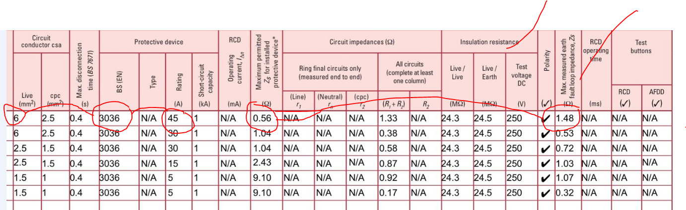

That quote is very confusing- it looks as if you're being ripped off but hard to tell. Can you take a pic of the circuit lists on the certificate & post it- that'll give everyone a clue as to what is needed
Does this help?

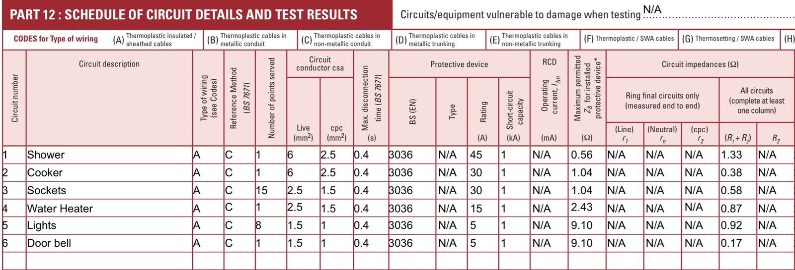

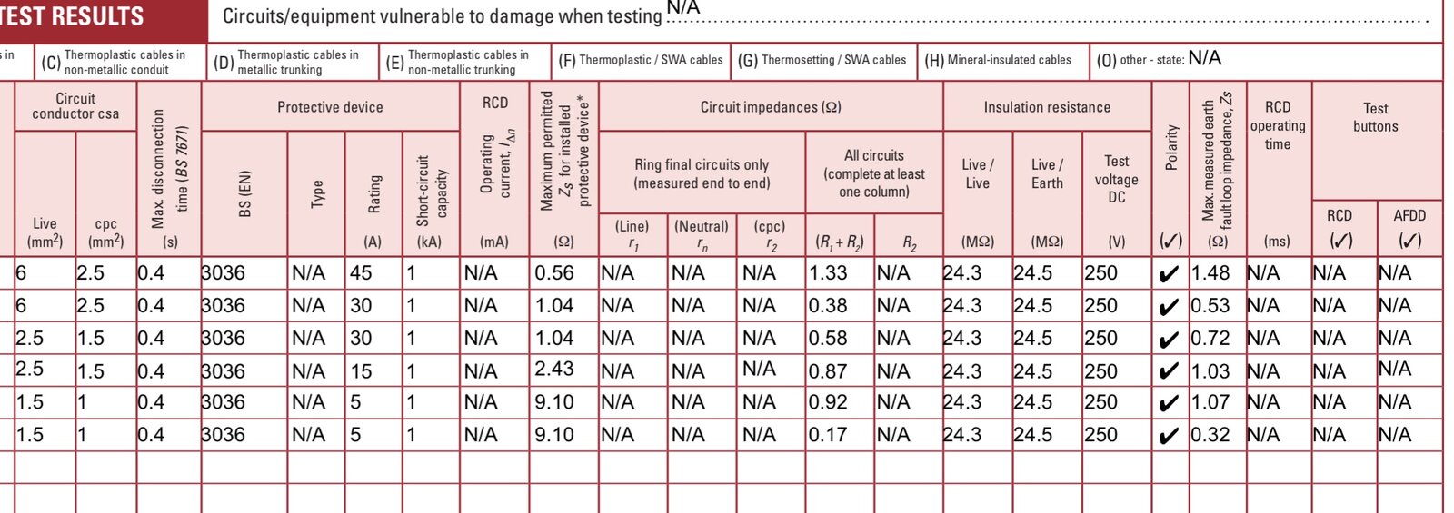

Does this help?
There are a good few iffy things about that Schedule. For starters....
...the Insulation Resistance section is all wrong. Testing at 250V is not really right, and the identiocal 9and 'odd') results for all ccircuits is 'interesting'!
... If the circuit supplying 15 sockets via 2.5mm cable, protected by a 30A fuse, is not a ring circuit, then that is wrong - but it probably is a ring, in which case the ring circuit tests should not be recorded as "N/A"!
Kind Regards, John
Shower circuit might be ok with omission of overload - but I doubt he realised that.
Definitely not with Zs.
