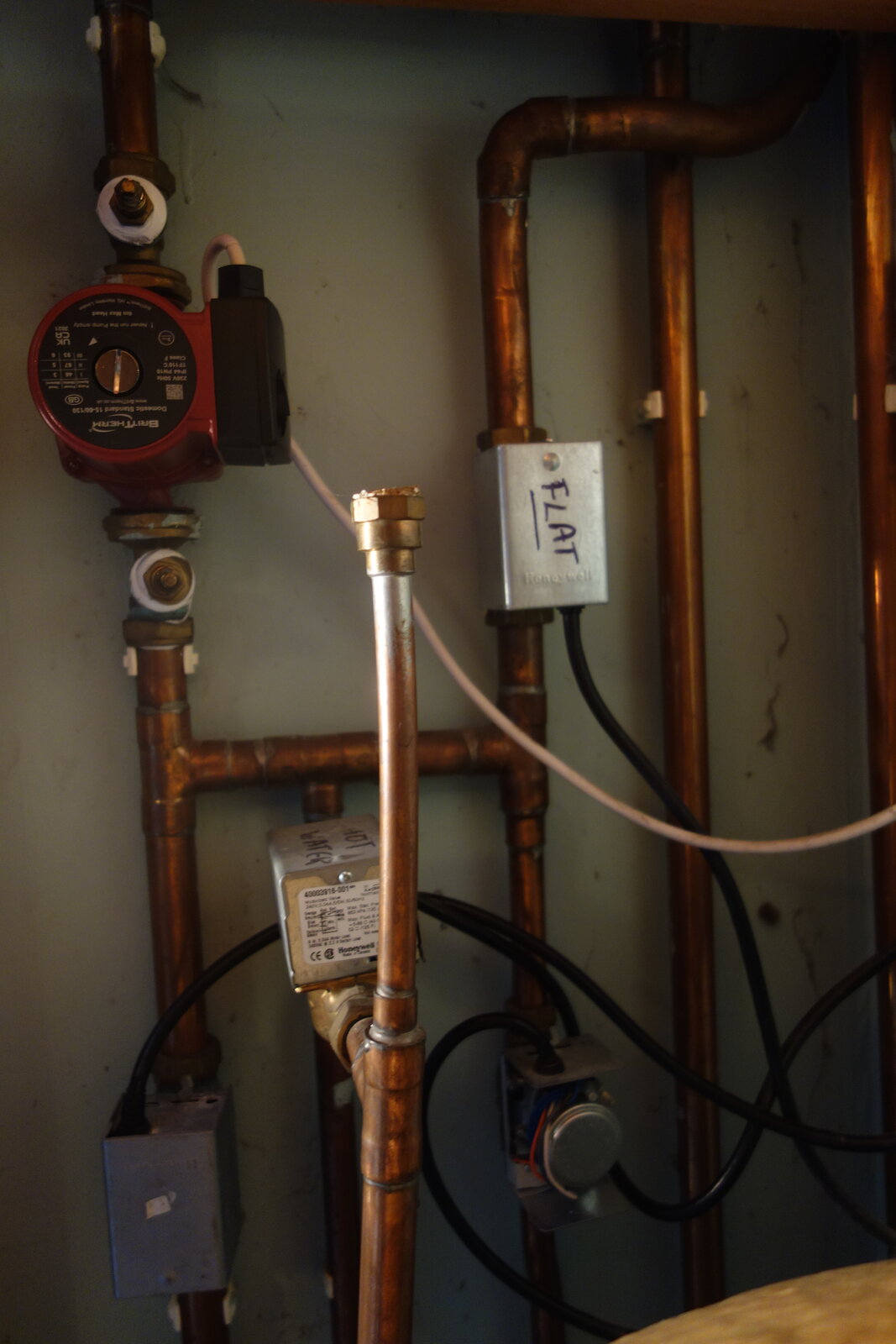

Hi all just changed the pump on my fully pumped system it was a like for like pump. System has 2 zones upstairs and down stairs. Turned it on pump works fine and upstairs works fine but downstairs doesn't come on at all . I opened the downstairs em valve manually but it still won't come on! In fact ho t water up to the valve cold beyond! Taken the Honeywell mechanism off and turned the valve with my fingers it moves freely but won't allow got water to flow? I live in a very soft water area (old pump Was fairly clean inside) My question is can these valves really block up inside? It's a very old system 30 ish years . Any help please thanks in advance

Hi many thanks for getting back , air in the system could be a problem I guess, So I drained down the system from a valve at the lowest point in the system in order to install the new pump. (I am not an expert of course ) The system refills when I turn the water back on. I have bled all radiators and gone back to the drain valve and checked that water comes out rather than air. When I turn off a working upstairs radiator it goes off as expected! The pump was installed the same as the previous pump. (I must stress that the system has worked fine for 30 years) The pump installs upside down (to copy the previous pump) ie the label is upside down. Again thanks to all (Happy Christmas)

Take a picture of the pump and the settings its on. Make sure you show the arrow

So I re drained the system the water was clear no bits in it. Re filled with all em valves open bled the radiators still the same problem the house has 3 floors an em valve for each plus one for the hot water. So in the picture directly opposite the pump is the middle floor which works fine. On the right of the H is the top and ground floor. The top floor works very weakly and the ground floor lower right of the H not at all. Awaiting your ideas thanks !

Pump should be pumping downwards. Have you checked the air release valve on the end of the up leg? Unlikely anything has blocked up whilst you changed the pump if it worked before. What was the reason for changing the pump?
Hi thanks again is this the valve in the middle of the pic . I have bled it !
Does the speed setting/output on the new pump match the speed/output on the old pump?
Have you set it on max for 10 mins to clear out the air locks? (Might help)
