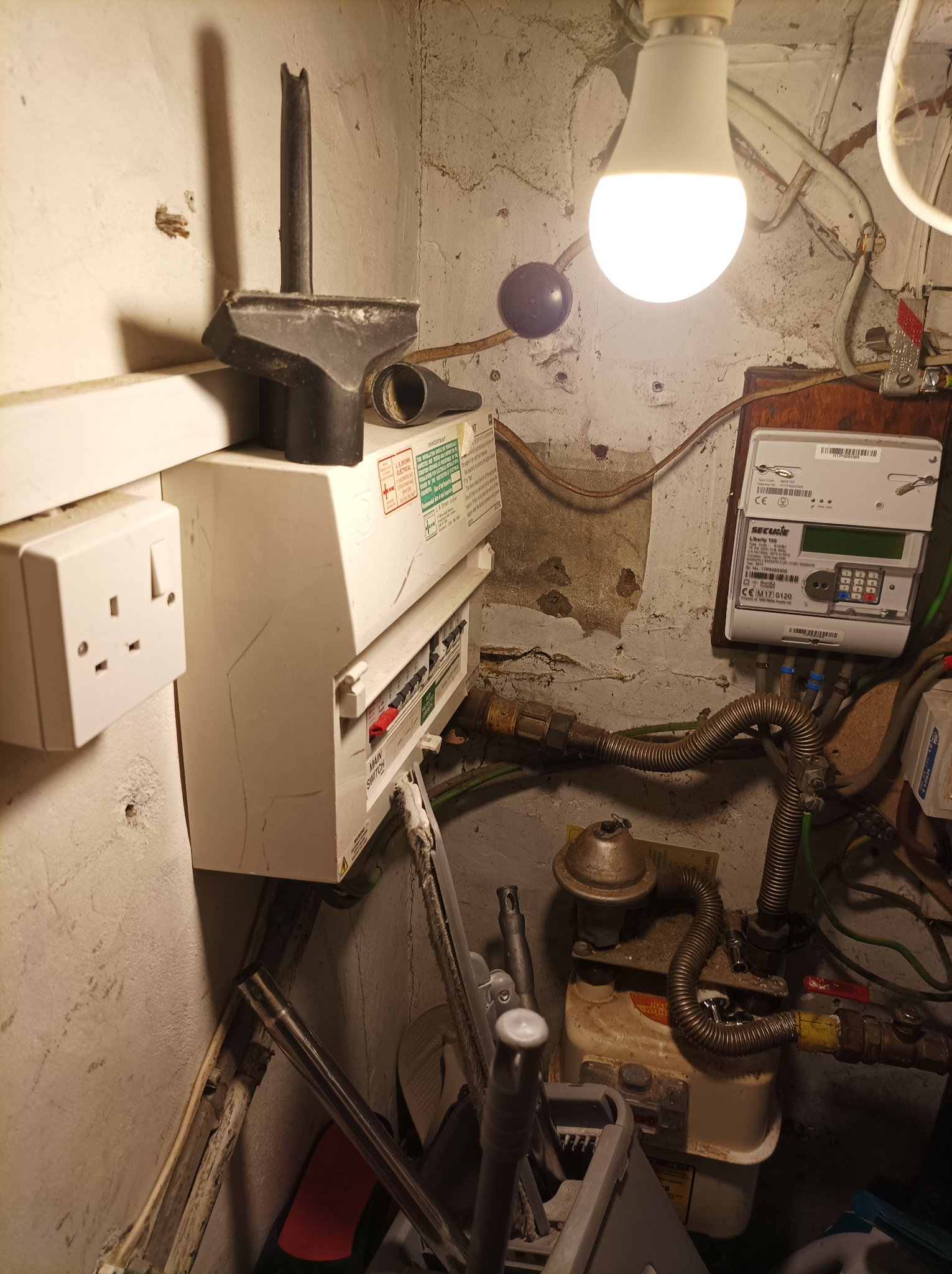

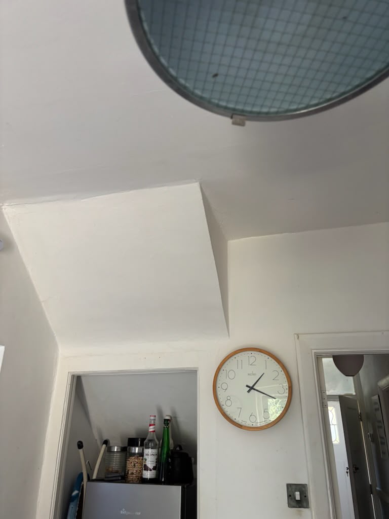

I live in a one bed 1930's conversion, the flat upstairs is rented. The landlord has to put new earthing to the flat upstairs and has said they will attempt do it from under the stairs (where my fuse box is situated)
They have said if not they may have to do it through my kitchen and add trunking. I am very accomodating to the landlord upstairs, but there is no way I am having ugly trunking in my kitchen
Can any one advise?
Tell him it has to be hidden and that you won't allow trunking. Is it your flat downstairs?
yes downstairs is my flat and the picture shows above the fridge where they want to put the trunking
Just explain you are happy to help but don't want any trunking showing.

What I wonder in your case, is why it now needs a new earth? And also why it can't be run outside the building? Something is missing in the tail.
The supply fuse and meter must be upstairs in their flat. The supply in to the property comes from downstairs I am assuming and the inlet is under the stairs to their flat in mine
I think alarm bells are sounding. Do you think he or his sparks are planning on attaching the new main earth to your CU?
All sounds very odd to me, normally if a house is converted into two flats then the norm is to have the mains split between the buildings where the upstairs flat will have a mains fed from an isolator and terminated into a consumer unit upstairs and same for downstairs, if the person in the downstair. flat should put a nail through the wiring for the upstairs flat by mistake or no fault of his own then the person above would have to have access to the downstairs flat in order to undertake any repair, the damage caused to the downstairs flat in doing this would be very inconvenient and possibly expensive. It all sounds a bit of a bad design and a botch to me.
