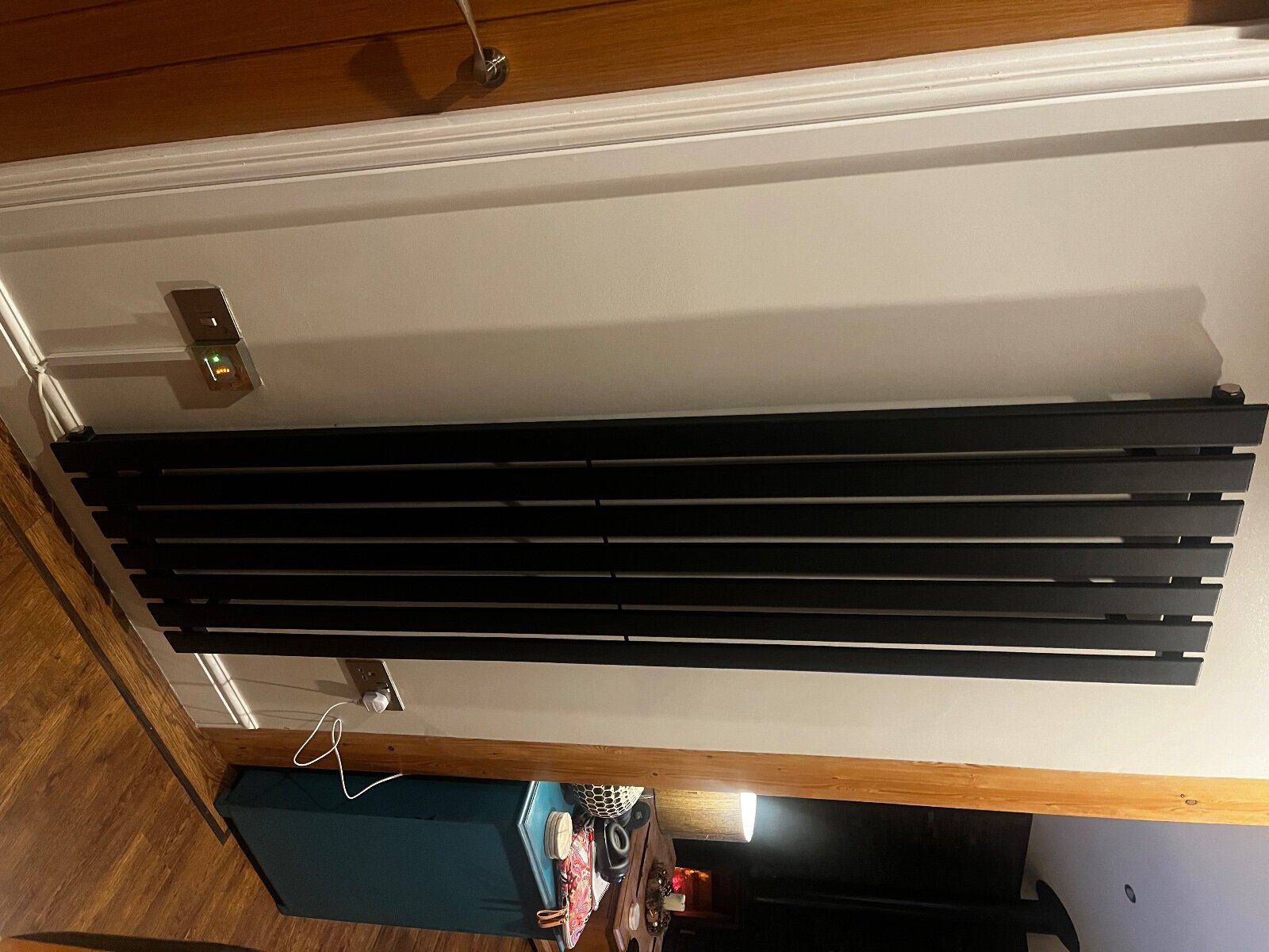

Good evening,
I have 3 vertical electrical radiators that are not heating all panels.
With them being electric, I’m not sure if they contain water and need bleeding or if it’s something else.
The two panels that are near the power get red hot but the remaining five remain cool.
I have attached a photo of the radiator.
Thanks in advance.
Yes they contain water.
I suspect that they have some sort of baffle that prevents the hot water from reaching all of the columns. If this were connected to central heating, you would want to prevent the hot water from entering at one bottom corner and leaving at the other bottom corner without rising. They do that with some sort of restriction in the middle of the pipe along the bottom.
That may be removable; or, they may not be suitable for use with an electric element.
Did you buy them?
Thanks for the info, no we didn’t purchase them. They were installed when we got the property.
