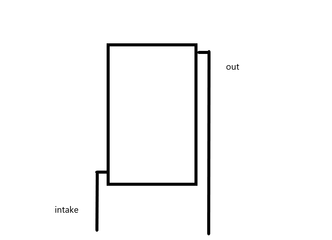

    Hi Again. Didalio makes a good point. Having to bled some water to create flow everytime it goes cold is no fun. I'd rather a rad keep me warm than look nice. If it always works after a bleed i would pipe it up in the diagram i posted. That should hopefully create a flow thru the rad.

    Yes good suggestion, in fact it's actually slightly more efficient to pipe at opposite top and bottom because then the hot water enters at the top, falls gradually as it cools and then leaves at the coolest temperature when it hits the bottom. Just make sure not to have the return at the top as then the hot water would enter at the bottom (if it's working) then rise straight to the top and leave without warming the rest of the panel

    Would the last panel still get hot?. Was just wondering whether the water would shoot up and then head towards the return rather than making it way down into the other panels?

    Correct that's why you have to do it the right way, the idea that the entry is at the top and exit at the bottom. Then the density of the cooler water will cause it to fall to the bottom.

    But this diagram shows the intake at the bottom.

    Oh yes I misread the labels, in that case probably better to do the other way round from the diagram, although Martin might have an even more reasonable justification

    In my small mind it would make sense to have the flow at the top so the hot water doesn’t have to try working it’s way UP the panels. But that’s just me and welcome thoughts from the more knowledgable.

    Anyone?? Should the flow go at the top and return at the bottom? Or the other way?

    I just realised my post was a bit ambiguous, but i thought given I'd explained why it should be clear, flow at the top, return at the bottom.
