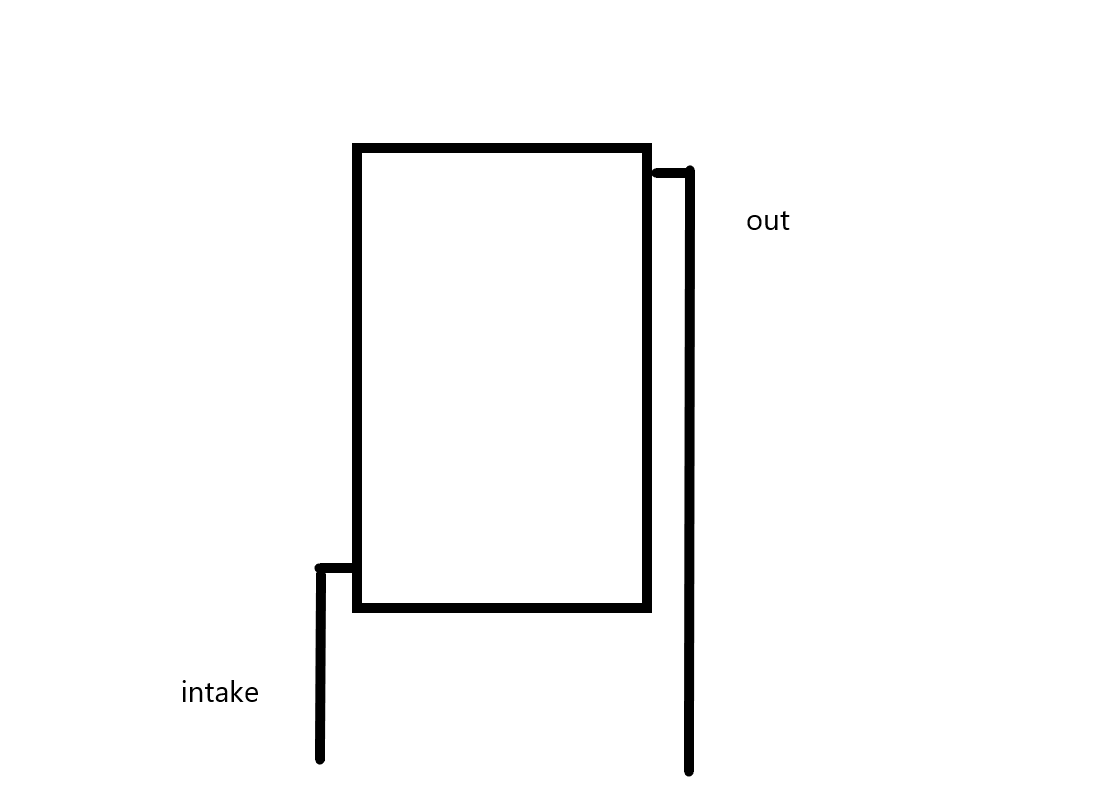

Vertical radiator loosing heat

If you can try piping the out pipe from where the bleed valve is instead.
What make Rad is it ?
Sorry i no artist.
Creates a diffrent flow for the rad.
Silly question but is the rad fitted the right way up. It maybe an internal baffle issue . Have another look at the instructions for the fitting and check that was done correctly.
this was checked when the rad got installed. The baffle is fitted just past the first panel at the bottom.
Rad is right way up.
intake and return right way round.
Baffle in correct place.
Pump speeds altered and still same issue.
Balancing done.
Flushed.

Take the rad off and connect the valves together using a length of barrier (plastic) pipe, with inserts nuts and olives.
This will prove if its the rad or system/pipework that is the problem.
