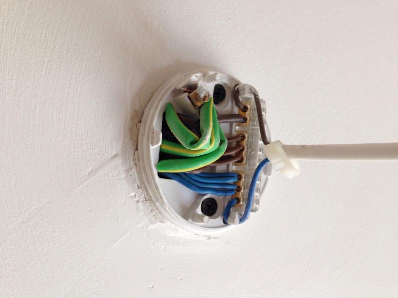

There may be 3 earth sleeves visible, but there should be 5 earth wires into that rose.
Whether 5x 1 milli conductors will go into one connector, I'm not sure. Is the cable 1.5 or 1.0 milli?
Also important to consider is how much slack there is in the ceiling void, as you need a bit to pull down in order to terminate comfortably.
Otherwise, you'd need to fit Wago's or similar and extend to the fitting.
