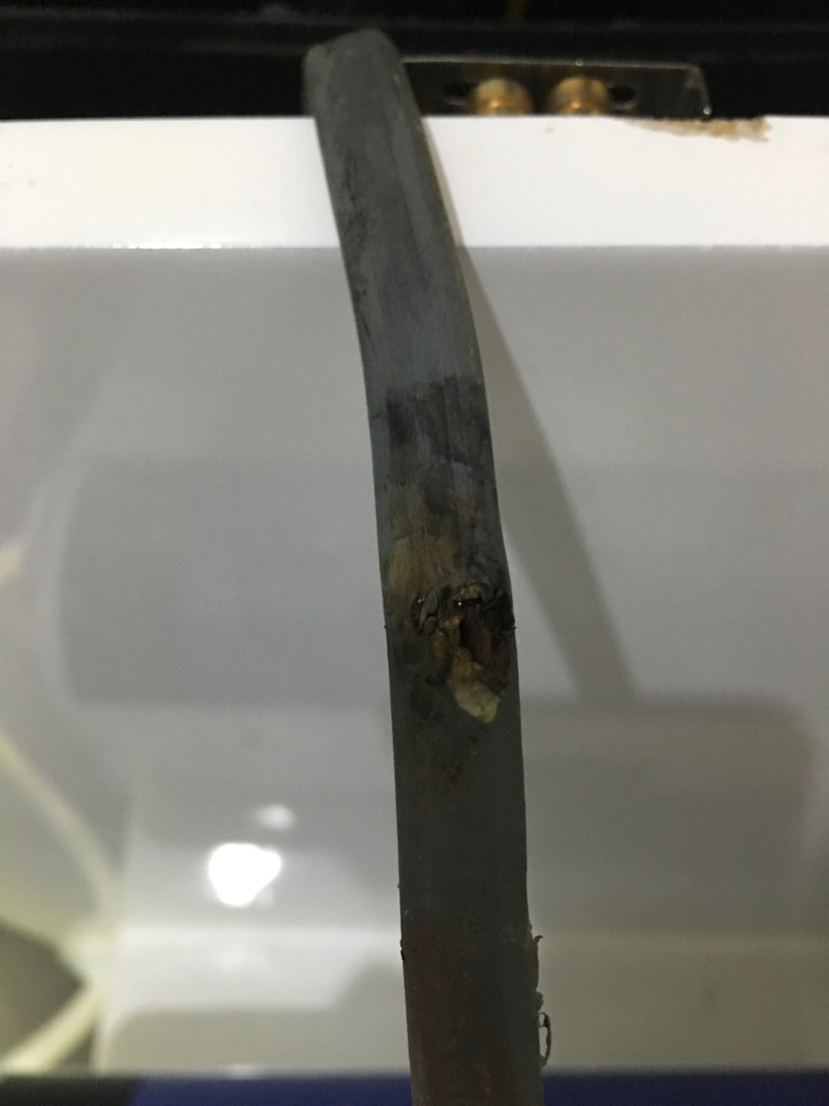

So far we know the problem is with the toilet or its wiring upstream up to the fuse that blew in the fcu, but what I don't understand is how faulty wiring would only cause a trip when an appliance is in use?
Is there a small heating of the cores causing them to move closer together? If it's not the toilet Perhaps the OP should check the wiring between the waterproof socket and the fcu?

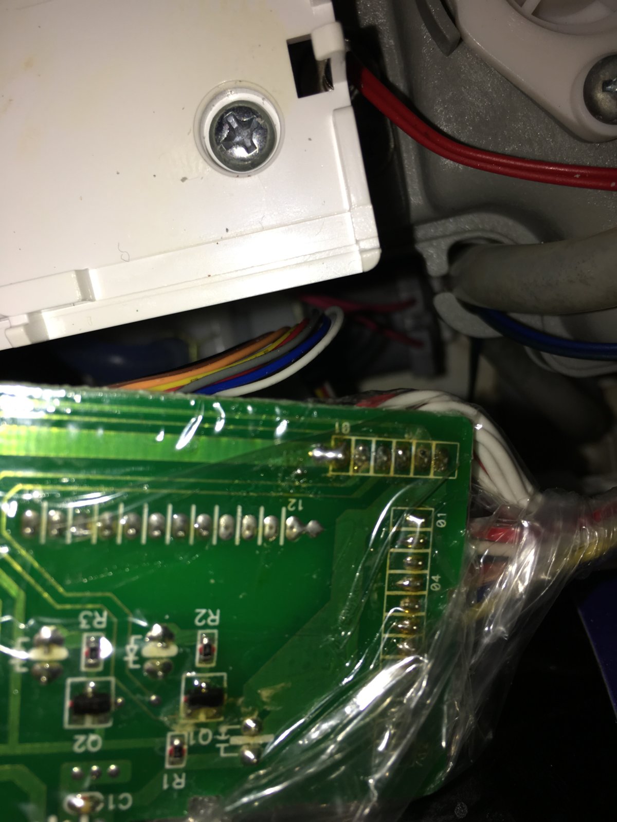

I found some 'damage' to several of the solder points on one of the pcbs in the toilet last night. It looks like some brown liquid has started seeping out of them. I tried to get a photo but the pcb is inside a waterproof plastic bag and it is proving tricky.

I can't see the brown but it could just be flux residue from when it was soldered. Especially If they didn't clean the board after soldering a manual component at the end, that would explain it. If it were black/sooty marks it would be noteworthy.

The big problem with inspecting anything is that most of the electrics apart from that board are encased in a jelly like substance for waterproofing. I can't see the back of the board where the power supply connects and most of the rest of the components can't be got at without destroying things.
There is no point in inspecting the innards of the toilet seat. The fault is almost certainly in the wiring at the socket or between the socket and the FCU.

I've got quite a lot of t&e in the loft so might just replace the cable. I'm not sure I'll be able to get the old one out and inspect it. I think it might be clipped to the joists and I wouldn't be able to get to it without pulling the tiles.
I can route the replacement by taking up some boards under the bath.
