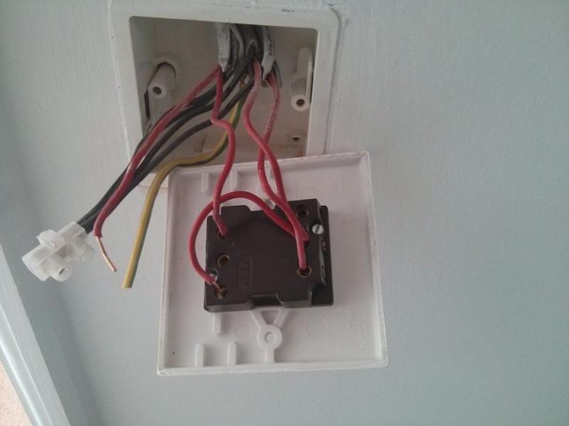

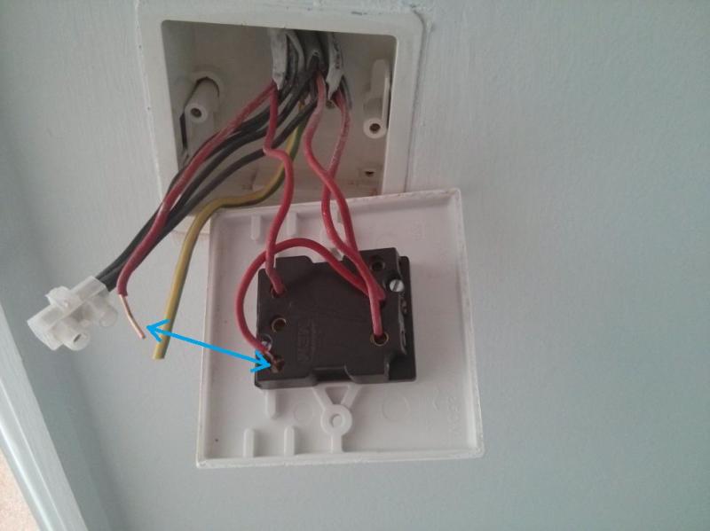

So I checked the master bedroom switch which is a 2 gang 2 way as there are 2 ceiling pendant lights and found this which looks horrific but I'm no expert:
The wire which loops from one side to the other didn't even have a screw in it on one side but the lights still worked.
Wires along the top A 1 way is connected along with B COM

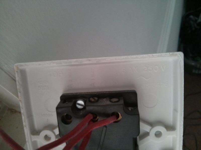

Wires along the bottom - A COM and B 1 way:
The loop connects A 1way to B one way.
What the spare wire is doing I have no idea and the earth is not connected to anything.

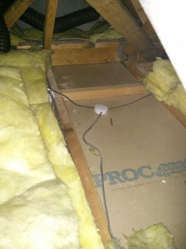

The FCU - I will replace the fuse and check. It does run in to a junction box in the loft which also has the bathroom extractor running in to it.

The first picture shows a live cable that is not terminated, that would be the first thing I would be looking at correcting, it is very much possible that this is the reasoning behind your power loss.
I would be thinking that if you terminated this in to one of the switch terminals that has the link across it (I think the switch terminal that shows the link on it's own, showing the copper conductor, could be used, make sure both cables are terminated fully with no copper showing, but not trapping any of the PVC insulation within the terminal) you should hopefully be getting power back to the lights then.
Do you have a means of safely testing for voltage?
I also suspect that there will be a number of CPC/earths within the green&yellow sleeve (possible 3), these should ideally be individually sleeved and terminated together in a connection block, not twisted together in a single sleeve.
Thanks again for the reply - All sorted!
I terminated the 'spare live' as indicated and hey presto, everything came back to life including the FCU.
So it looks like those two wires had just been looped and pressed in together without a screw for 17 years before finally working their way loose!
You were right about the 3 earth's in one sleeve, I've now separated these out and terminated into a small block.

As for the switch...did you manage to pinch a screw from another unused terminal to secure those conductors?

Yep, I used a screw from one of the unused terminals.
