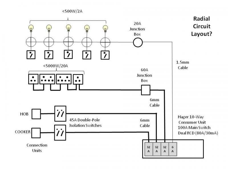

I was hoping that some of the members that helped me understand the issues surrounding installing some new electrical circuits for a new kitchen/utility room might have a quick look at the attached circuit layout.
The proposal is to replace the existing fuse-box and 6 circuits with a 10-way consumer unit (Hager) with dual 80A/30ma RCDs. Looking at the overall current loading, 80A RCD, rather than 100A, seems fine as the latter are quite a bit more expensive.
All the new circuits are radial circuits, such that I have used thicker cables than in a loop design.
Cooker and hob will be on separate 32A MCB radial circuits using 6mm cable. These will be connected to the CU and tested by the electrician.
The new utility mains circuit will be on another 32A MCB radial, also on 6mm cable, although 4mm might be enough – not too sure on this point. Maximum current loading should be less than 20A, but includes washing machine & tumble dryer.
The new utility lighting circuit will be on 6A MCB radial, using 1.5mm cable. Maximum current should be <2A.
The 20A/60A junction boxes are required because this utility circuits will initially be wired up to the existing fuse box and then moved to the CU once all the kitchen rewiring is complete so that any possible problems with RCD current leakage in the existing kitchen might be avoided.
Would really appreciate any expert advice or corrections to the proposal before talking to a professional electrician to be used for the CU installation and circuits testing. Thanks

What makes you think that an electrician will be happy to sign this declaration when he did not do the highlighted activities?
I being the person responsible for the design, construction, inspection & testing of the electrical installation (as indicated by my signature below), particulars of which are described above, having exercised reasonable skill and care when carrying out the design, construction, inspection & testing hereby CERTIFY that the said work for which I have been responsible is to the best of my knowledge and belief in accordance with BS 7671:2008, amended to 2011 except for the departures, if any, detailed as follows:
I was possibly hoping that I might be able to carry out a lot of the installation of the new wiring for the kitchen and utility using the old fuse box, then get a qualified electrician to fit the CU+RCDs+MCBs plus connect and test all new circuits before doing the necessarily notification for me. Is this possible, i.e. would an electrician agree to this?
You might find one, but you'd have to agree everything in advance.
You will not find one prepared to sign a declaration to say he designed and installed the circuits if you present him with your fait accomplis.
You seem to be carrying on with your plan in disregard of the reality that it won't work.
Your idea will not mean that you won't have to apply for Building Regulations approval in advance, and it will not mean that you'll end up with a valid Electrical Installation Certificate at the end.
Not good enough. You've decided that you are capable of doing electrical design work, but you aren't sure what cable sizes to use?
What does Ib &#8804; In &#8804; Iz mean to you?
Why that size?
Why can't the new cables be left long enough to reach their ultimate destination?
You need to use a professional electrician for all of it, not just connecting your new circuits to a CU and doing the testing.
I don’t, that is why I will call in an electrician prior to starting any work.
I won’t argue about the letter of the regulations, although I am not sure that the ‘real world’ works to such exacting requirements. Of course, if it does, then I will have to paid an electrician to do all the work. However, presumably any electrician fitting a new CU to an existing house would not have ‘designed and constructed’ the original wiring, therefore only ‘inspects and tests’ the operation of the circuits when fitting the CU.
You seem to be carrying on with your plan in disregard of the reality that it won't work.. Your idea will not mean that you won't have to apply for Building Regulations approval in advance, and it will not mean that you'll end up with a valid Electrical Installation Certificate at the end.
Not true, at this stage, I am simply trying to understand what is involved and what design issues need to be taken into consideration. As indicated, I intended to discuss the design with a professional electrician prior to starting any work. If I can’t do any of it, so be it. However, I am not sure that a professional electrician needs to channel out the walls for the cable?
Not good enough. You've decided that you are capable of doing electrical design work, but you aren't sure what cable sizes to use? What does Ib &#8804; In &#8804; Iz mean to you?
Again, not true. I have not decided anything, I am simply trying to understand the issues.
Why that size?
http://www.diynot.com/forums/viewtopic.php?t=258334
Again, I am only trying to understand the issues so that I can discuss the options with the electrician. Surely, it is to the benefit of all parties that these issues can be understood by the customer rather than being totally reliant on the electrician, who I assume are not all born equal in terms of qualifications or experience.
http://www.govyou.co.uk/part-p-of-the-building-regulations-scrapped/
Excellent point to be taken on-board.
You may be right, but I have tried to explain why I am asking for advice and would still appreciate any further advice on the actual details of the layout. Thanks
Notwithstanding BAS's points (most of which are valid), I think that you proposal is conceptually reasonable, and certainly a good/adequate basis for your up-front discussions with the electrician who will be involved.
Your electrician will undoubtedly have views on details of your proposal. In particular, (s)he may well feel that all your proposed cable sizes represent 'overkill' - not just the 6mm² cable for hob and oven circuits that we've already discussed, but also the 6mm² for sockets circuit and 1.5mm² for the lighting circuit. (S)he will probably also have views on the optimum ways to distribute the circuits between the two RCDs in the new CU. BAS's suggestion that enough spare cable be utilised so that the definitive connections to the new CU can be made without the need for joins in JBs is a good one.
