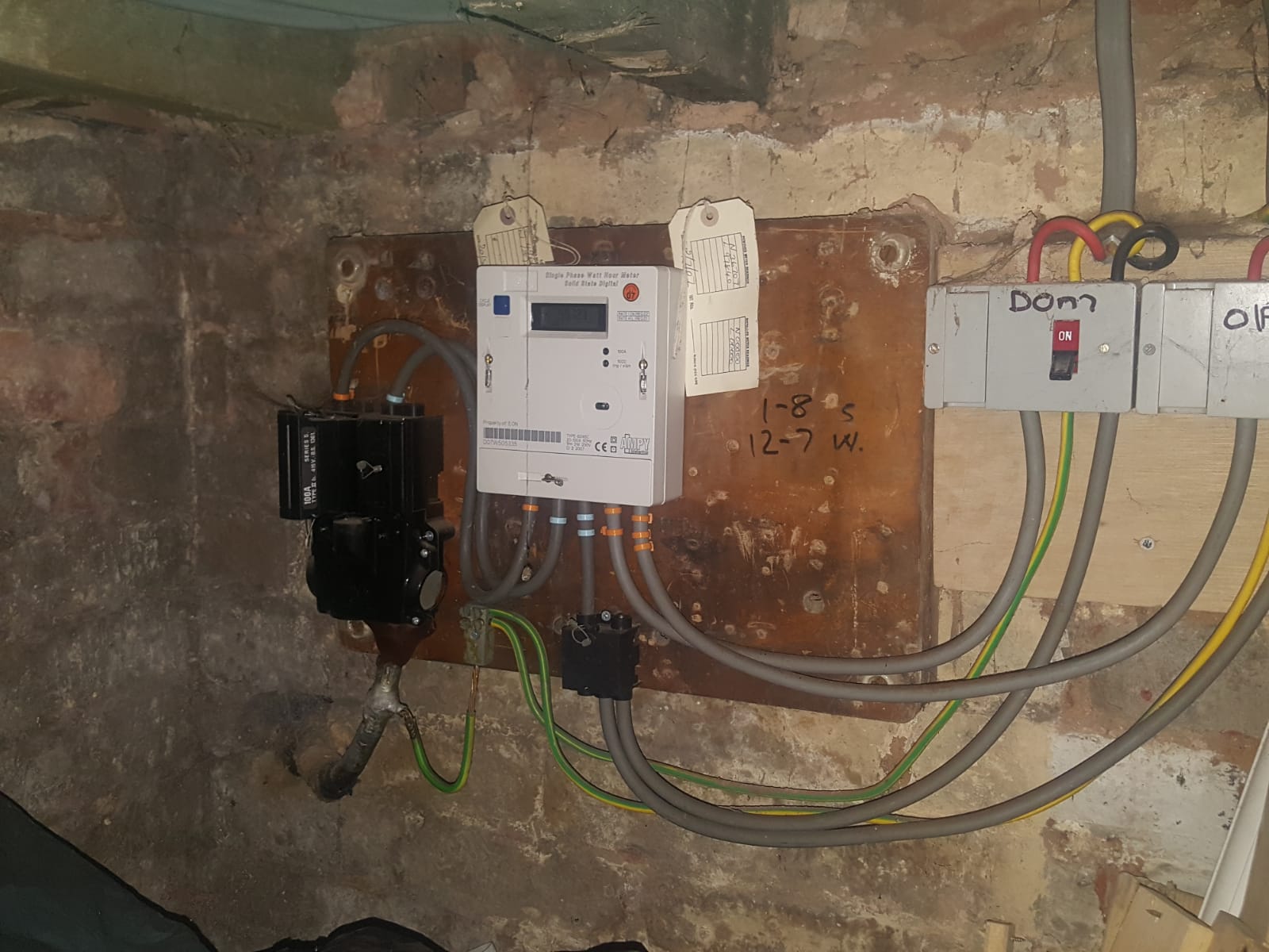

Building a shed which will be 50m from meter in the house. Will have 3 double sockets and 2 lights. Not to be used for anything heavy apart from occasional use of an industrial sewing machine.
Looking to have a rcd protected cu in shed: something like this
https://www.screwfix.com/p/british-general-5-module-3-way-populated-garage-consumer-unit/1926g
Will lay 6mm swa cable at a depth of 500m under lawn and ideally would like it connected directly to fused switch which was initially used for economy 7 cu that is now obsolete.
Will do all the manual work myself to save costs, with the electrician doing the connections at both ends. Will this be ok, connecting directly to fused switch?
500m underground will take some effort.
Do you have a picture of your consumer unit/fuse box? The picture supplied is your meter and supply.
That appears to be connected to the 5th terminal of the electricity meter, so would only be on at E7 times, rather than all the time.
Moving it to the permanently supply would be possible - but the fuse in it will probably be a 60A or 80A, so not suitable for use with 6mm² SWA. Smaller fuses are physically smaller so won't fit in it.

New switchfuse in the house next to the meter - armoured cable to shed - new CU in shed.
House CU is unrelated.
