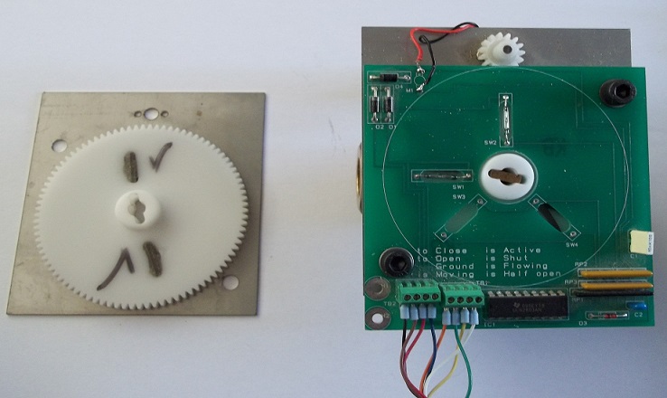

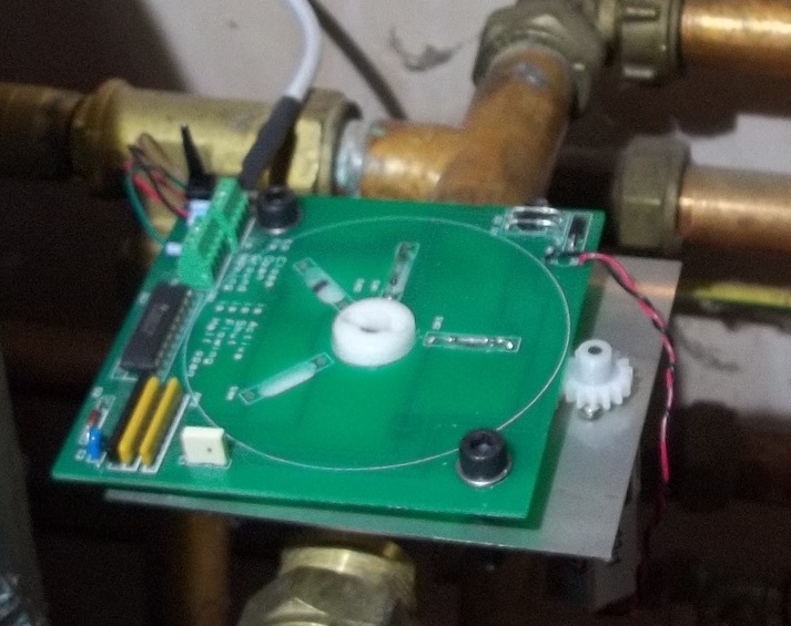

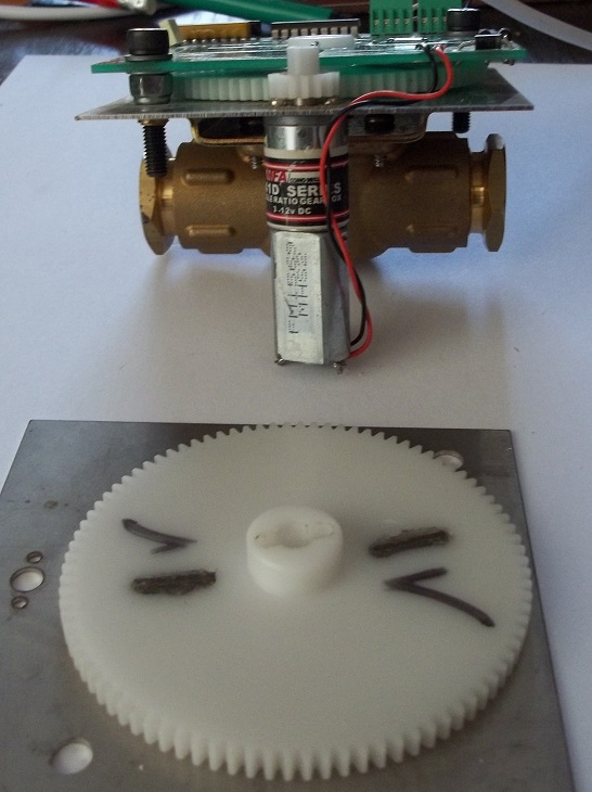

With a few years experience of living in the cottage an update,
The control system has been simplified based on that experience.
The doors upstairs are original ( ancient ) cottage style which allows warmth from downstairs to get to all the rooms upstairs. Other than in very cold weather one radiator in the dining room at the bottom of the open plan stairs keeps bedrooms and bath room comfortable warm.
It has been reduced to be 24 volt wax valves on three radiators ( bedrooms and lounge ) and my "home made" 12 volt actuators on the two hot water cylinders and one radiator ( dining room ).
Originally the plan was to have motorised actuators on all radiators but wax operated valves are more convenient in terms of size and silent
operation.
Did you salvage the large gear from an existing actuator or are you a 3D printer?
Magnets embedded in the gear wheel activating reeds?
Is this a paddle or shoe valve...if the former how are you pre-loading the paddle to ensure full shut-off...normally that would be done by a couple of springs.
Large gear is a stock item and then machined to fit the shaft on the valve, 90 tooth Mod 0.8
Yes magnets activating reed switches, the IC is a ULN 2803 ( 8 darlington drivers )
Not a paddle valve but a ball (?) valve, only rotates in one direction.
