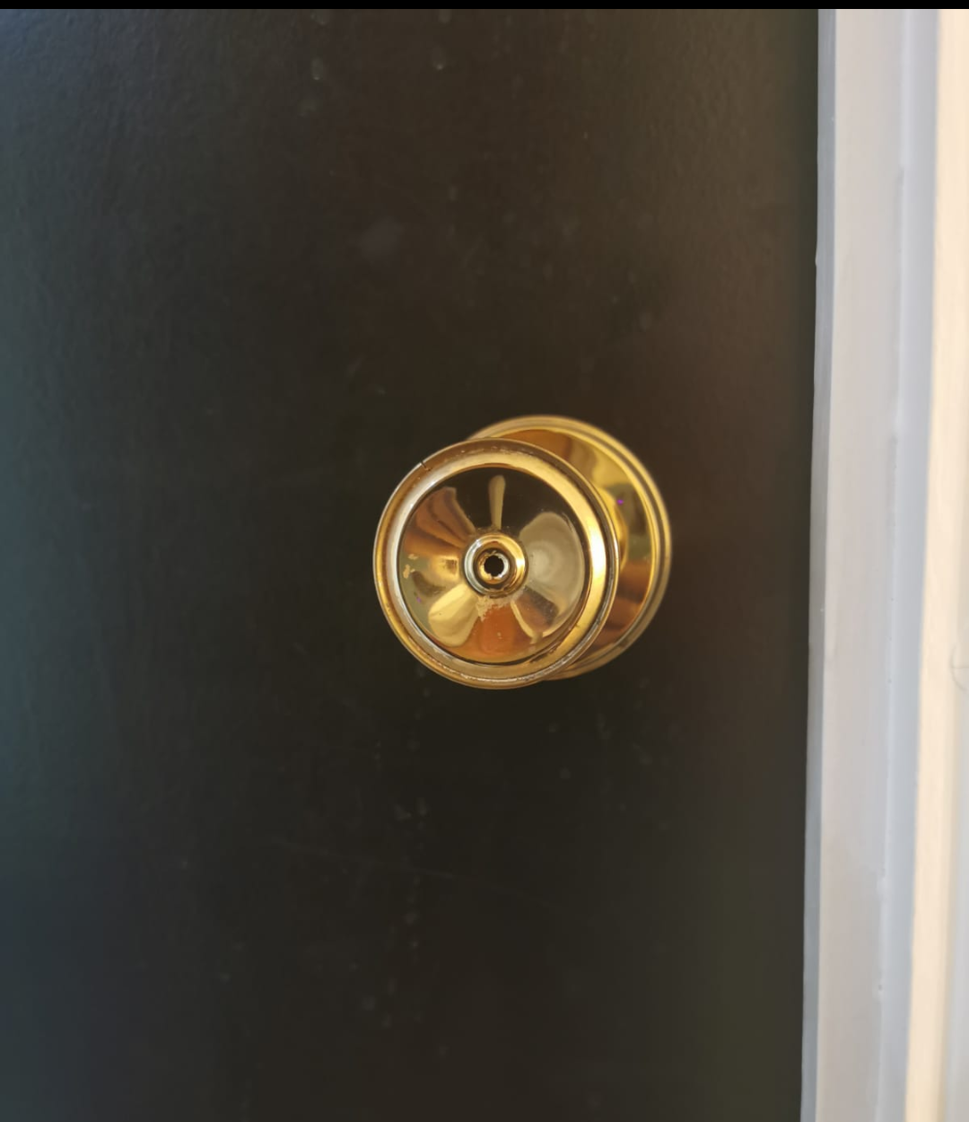

Went to use bathroom and somehow it has locked on the inside by itself.. So i cannot access the bathroom
Does anyone know how to unlock, this type of lock from the outside?

Unfortunately, I didn't get any joy with the pin/paper clip..
I then switched to the Jewellers Screwdriver
Stuck it in the hole, there was some sort of catch in there. Had to turn clockwise (to unlock) and push. Then presto
Thanks again, your link provided a good basis on what I'd have to do.
