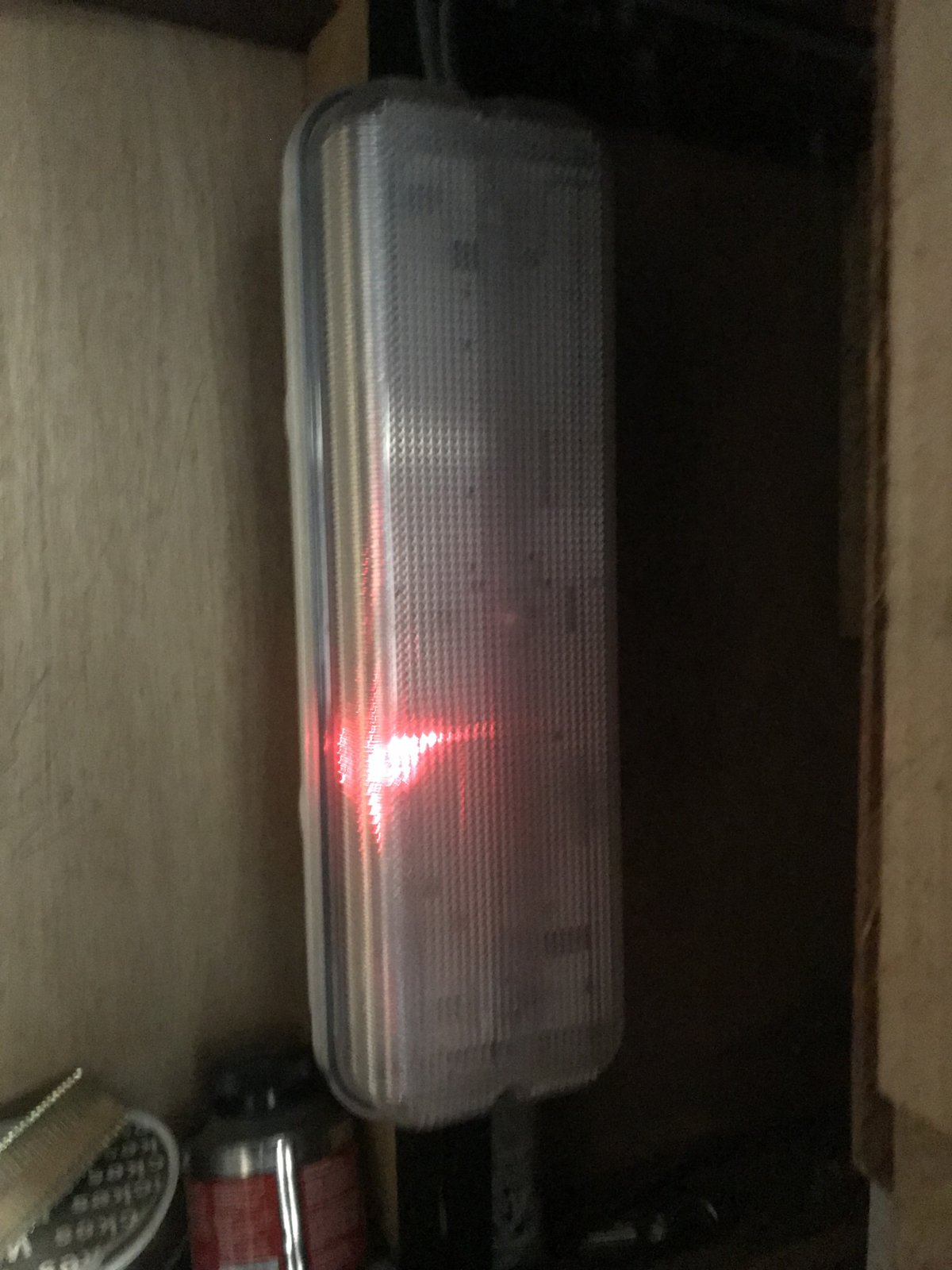

Back in the olden days when I was just a boy emergency lights used to have red LEDs to indicate they were charging. These days they are always green.
Does anyone know when and why they changed colour?
I came across this fitting the other day in a scout hut, and it passed the test, whilst some of the newer fittings failed to light at all, never mind stay on.
I seem to remember something about different colours for Maintained & Non Maintained but even that doesn't seem to match up.
Perhaps Green = good now o_O

I think it may have changed when self test fittings became popular, as they tended to be Green for good and Red faulty, we get a few calls where clients have thought lights were faulty due to the older fittings being Red, a lot of changes finally came into force I think year 2000, when the running man became legislation and the single word Exit was banned.
Also it may be in line with-
The Health and Safety (Safety Signs and Signals) Regulations 1996
Where Red and Green are 2 of the 4 recognised colours

As far as I know it was to do with eurpeon harmonisation and happened around 2006/2007. I seem to remember there being a bit of info put out by the manufacturers explaining the change and that some makes you could order either the older version, or the red LED (for ones on a flying lead) for if you'd got a project underway so you didn't end up with a mix.
On a similar note, while most fittings do impliment it as a "charge" led, I know of one varient where it is more "charge supply available" in that it'll light even if the battery pack isn't plugged in, I'm not sure whether there is any set guidence with this, but it seemed a bit backwards.

Where an electrical light source indicator is used, it shall comply with the colour requirements of IEC 6 0073 and be green
