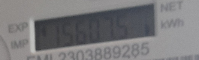

Am i correct? Also is there anyway of checking that my pv meter and my smart meter in the electricity box are correctly recording my consumtion?
i am a bit baffled by the EV meter as there is an arrow to the right of the screen pointing to KWH (KILOWAT HOURS) i assume, but also an arrow to the left pointing to IMP GEN this might mean imported generated but confused by the LCD display as there are no buttons to press to find out what the latter means.

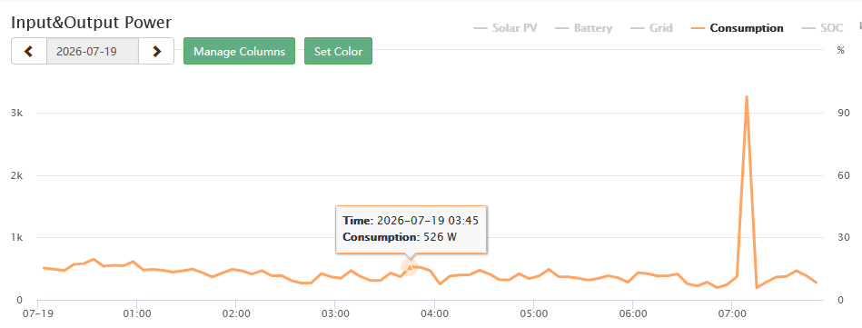

Two panels are not much, it is what is being put forward for plug in solar, but if I look at my background use. 1784444502341.png
I does not exceed 600 watt, and is often down to 250 watt, so solar output between 250 and 600 watt for me would be used in the main by background use. As the output from solar increases, one has two options, store it or sell it, at the moment to sell it we are getting around 12p/kWh and to get that payment we need a second MPAN number, and a smart meter.

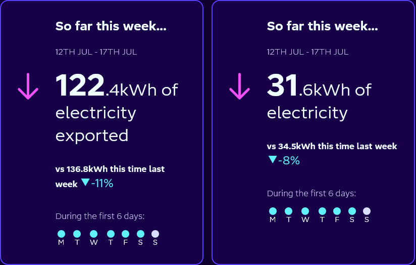

So your app should show something like this 1784446125691.png showing both import and export, for me to find out what I have used 20/5/2026 to 5/7/2026 I would need to add up each day

A picture of each of these meters (with serial numbers redacted) might be helpful. My generation meter has, for example, the lettering 1000 imp/kWh next to an led, which relates to the number of impulses of the led that represents 1 kWh generated. I also suspect that you need to add the two numbers to get the total you used, as I very much doubt that two panels will results in a net export.

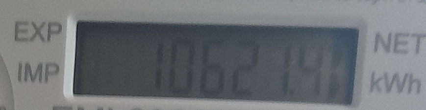

This is the reading on my PV meter, I will assume top one is total solar since install, as to bottom one I assume that is how much used to charge the battery. However, the meter has nothing to do with payment either for import or export, basic it was fitted in error.

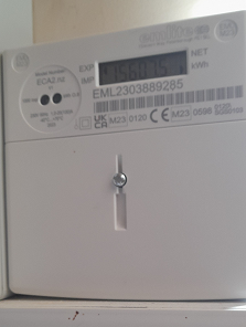

I wonder if you have a smart meter? This meter 1784556533876.pngwhich my solar has, is not a smart meter. I don't need to blank out numbers, as this meter as said has nothing to do with what I pay or get paid, but if you post a picture of the meter, do not include any numbers that identify the meter.
