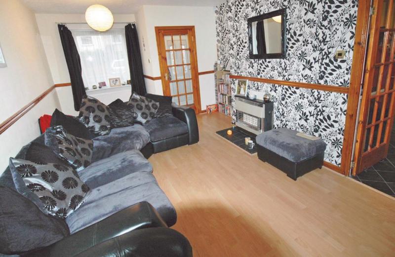

The F&B looks great, I used Elephant's Breath as the colour and it looks lovely, has a really nice depth to the finish compared to other paints I'd tested - I've had loads of compliments on it already. It's a lovely shade and the chalky finish sets it apart from Dulux and other emulsions I tested out which had a more rubbery appearance (I guess the higher vinyl content). Very pleased with the results - thanks again for the advice :)

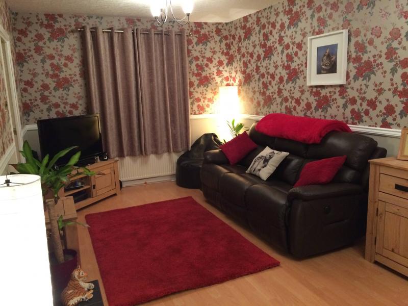

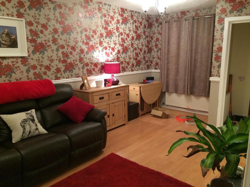

Before:
After:
