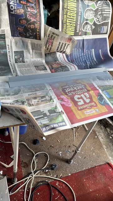

Hi
I want to apply spray enamel to galvanised steel angle L shaped from SF part No. 880JP. Do I need to spray metal primer first and then the enamel or can do without primer?

I applied Rust Oleum surface primer this morning; 2 coats, says to wait 12 hrs before paint, adhesion looks quite good, will enamel tomorrow, there is no rush, will update the result.
