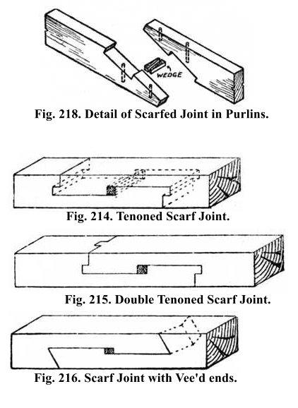

I have to join some 4.8m lengths of 200 x 47 timber ... end to end
This is on show so no desire to use fish plates or any metalwork ....
The solution seems to be to use a Scarf joint i.e:
http://tinyurl.com/ptks6ln
I have only created sliding scarf joints, not these ones with stops.
Is there a particular technique to doing these ...
Opt A ... I thought of simply marking out and hand-sawing as best I can ... then using the one 'cut' to be the template for the next end.
The issue is trying to get a very neat joint in 8x3 timber with a jack saw may be stretching things ......
Opt B .... rough cut to within 1/4" or so, and make a template out of plywood and run a router with collar and 2" worktop cutter around template.
Would cut such that angled 'glue area' is twice the depth, i.e., at least 400mm long.
Once I have them cut will put in plenty of PVA D4 glue clamp, and also drill some holes from underside through the joint and glue in some 10mm dowels, they won't go right through so not open to rain form above.
Open to any other ideas, or practical tips.
It's an external structure :?
Quick explanation ... 10m long Pergola being built ... 100x100 posts as uprights, along top of these posts will be bolted the 200x47 forming the side beams.
Will put 'gallows braces on first and last post for rigidity.
Across the top of the posts spanning between the 2 parallel runs of posts will be 100x47 cross beams, notched to depth of 30mm where they will be glued over the 200x47 beams.
There is nothing on top ... no dead load other that timbers own weight.

Here's some alternative scarf joints too the simple one you've provided. Notice the folding wedges that provide a drawing of the joints linearly. assuming the supports are well positioned in relationship to the joints, I believe they provide good support too the structure...pinenot :)

216 is the easiest as you can clamp in place and run a saw through both ends to give you identical touching surfaces :wink:
Should be reasonably easy with a table saw and a bit of careful hand work. To the OP the secret of getting stuff like this right is to have timber which is square with parallel faces, and the same dimensions. Mark out with a knife, a square and a sliding bevel, and then as out old woodwork teacher used to say "Cut on the waste side of the line" I don't really know much about structural joints in timber frames, but I thought that traditionally these joints were used either directly on top of a post, or on a beam where it actually runs through a mortice in a post. They're intended to give a strong joint in tension I assumed.

Tenoned scarf looks interesting ... but a lot of work.
maybe the dowelled scarf joing (1st in pic) is way to go ..
Anybody cut one of these, just wondered if there is any tip to get a tight fitting joint.
As I already noted, look at the folding wedges within the designs which effectively lock the joints, making the board almost one continuous length.
