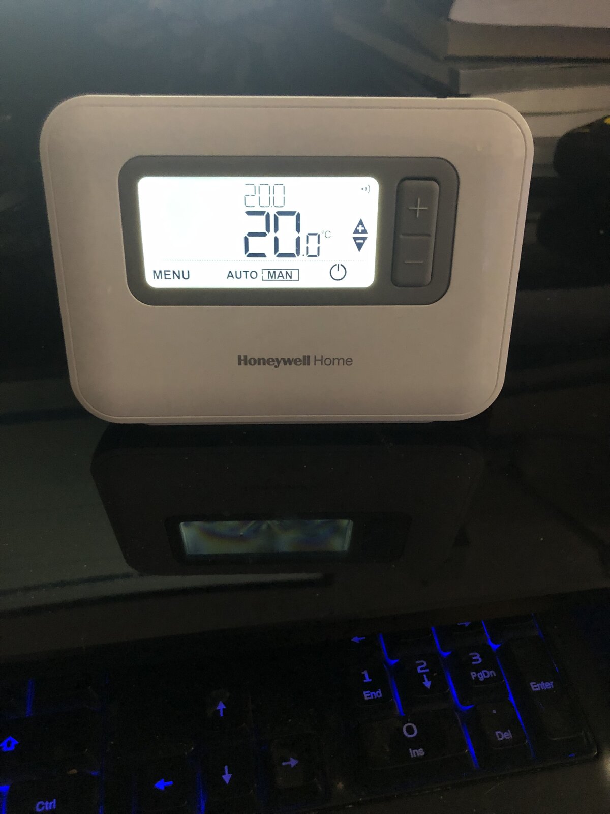

20 degrees?

20 degrees?

The implication is that you are well off as you can afford to heat to 20 degrees given current prices.Here ends any coherent discussion.
And, or was a light-hearted ribbing, to boot.The implication is that you are well off as you can afford to heat to 20 degrees given current prices.
Do you not have TRVs? Or is it heat leaking from downstairs?just turned mine down mrs thought she was having a hot flush currently room at 22.5 so turned it down to 20 .
