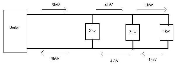

remember that that only 3 radiators are fed off 22mm pipework, and the rest are all fed by 15mm pipework.
As the rad output is only just enough, we will have to forget about running with a 20°C - you will loose 15% of the output if you do - 10°C it is. But this means the 15mm pipes are carrying far too much heat. You won't need to replace all of it. This diagram show how you work out the loading of the pipe work. You should be able to do this for your situation. The maximum going down a 15mm pipe should be 6kW.
