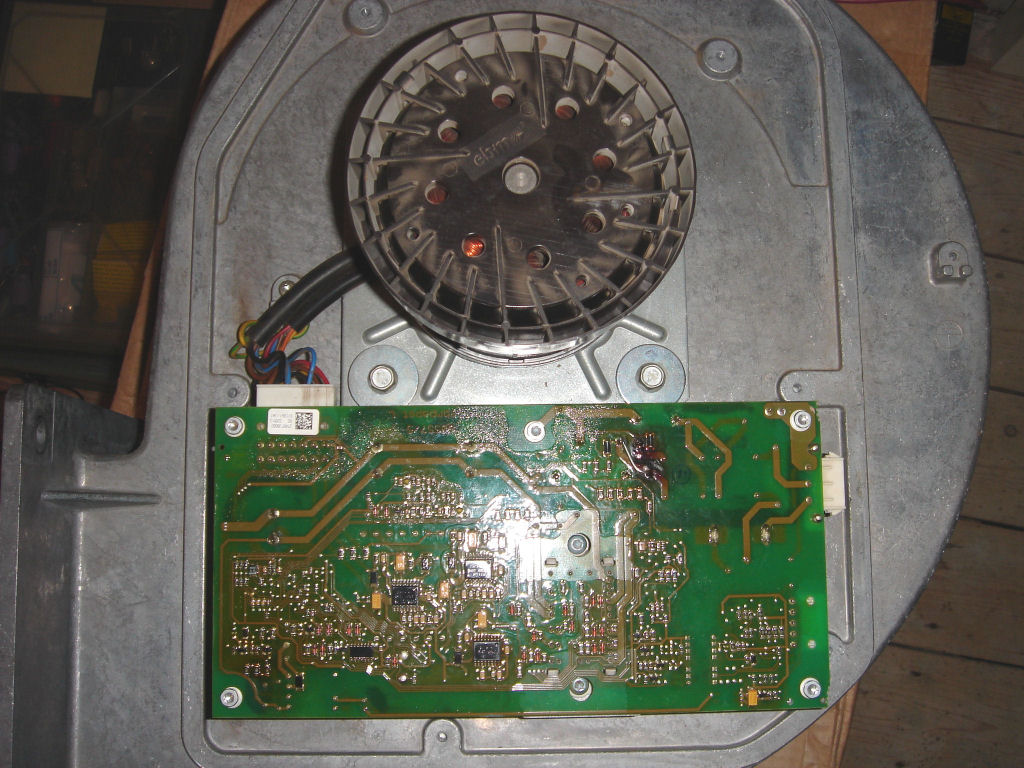

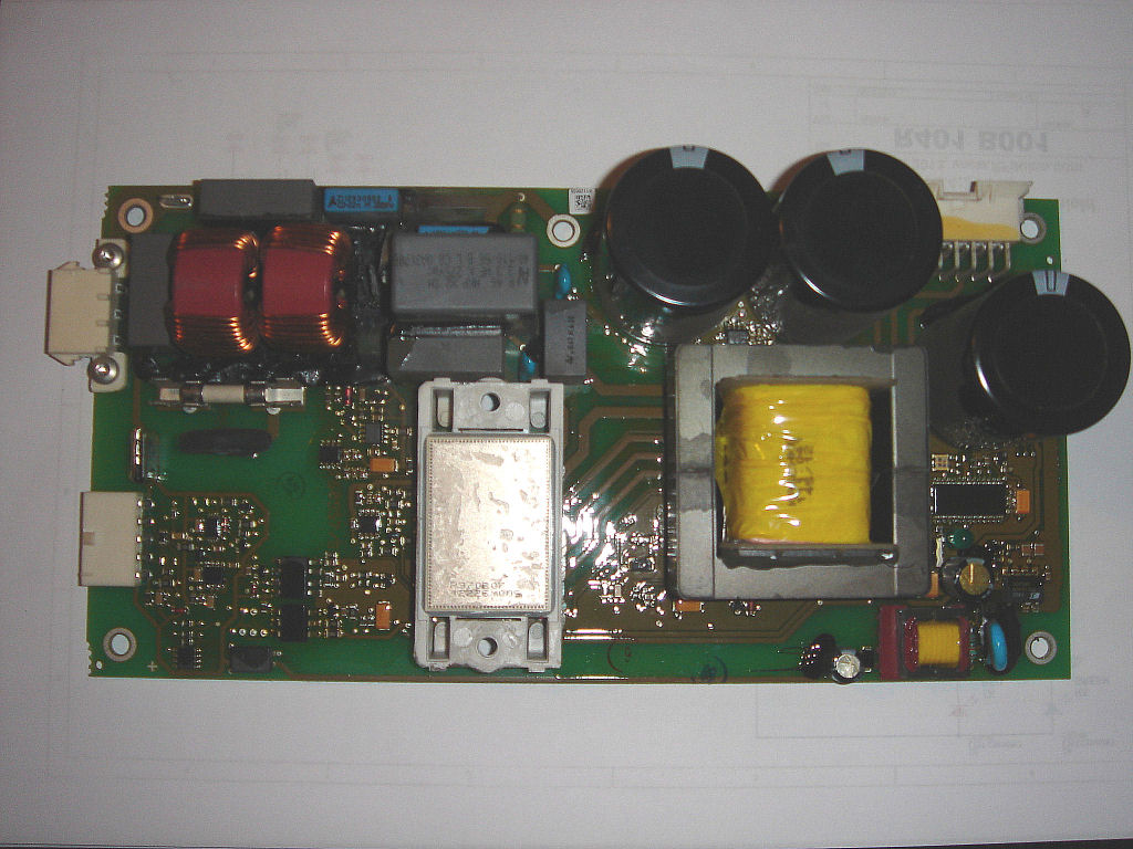

Here's a 3 phase driver board from a commercial boiler combustion fan...over 200 components (and active power factor correction) with a custom designed output module...the rectangular module is stuck to the fan casing with thermal tape. About £2500 new :eek:
Why does a boiler need such a complex fan? Once water is boiling sending steam up the stack will cause a draw. However the problem with advancing technology is working out is it safe, if you fit anti-stall technology to an aeroplane and a fault can cause the plane to dive into the ground it is clearly not safe.
