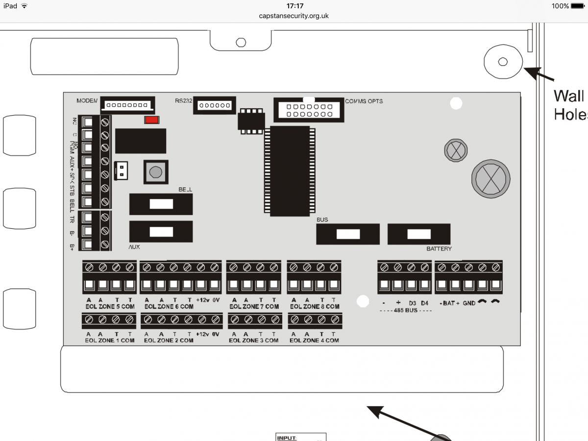

Afternoon All
So for some reason unknown yet to myself, I decided to change a broken PIR myself, whilst doing this I touched the wires together and lost all power to the other PIR's, I have a message on the panel stating:
Aux fuse FLT 100
I cant get hold of my alarm engineer who I think is away on holiday so wandered if its possible for me to change the fuse, I do have code for engineer so can access the box without setting the alarm off.
Question is does anyone know what I have to buy and where I can get them from over the weekend :(
Any help appreciated
IMG_1502.PNG 800ma fast blow ....would be ok with a 1amp ....try maplins
Thank you, just managed to get down there before they shut, have installed said fuse and all is back working.
Appreciate the fast response and also the picture of the box as i was able to locate it with ease
