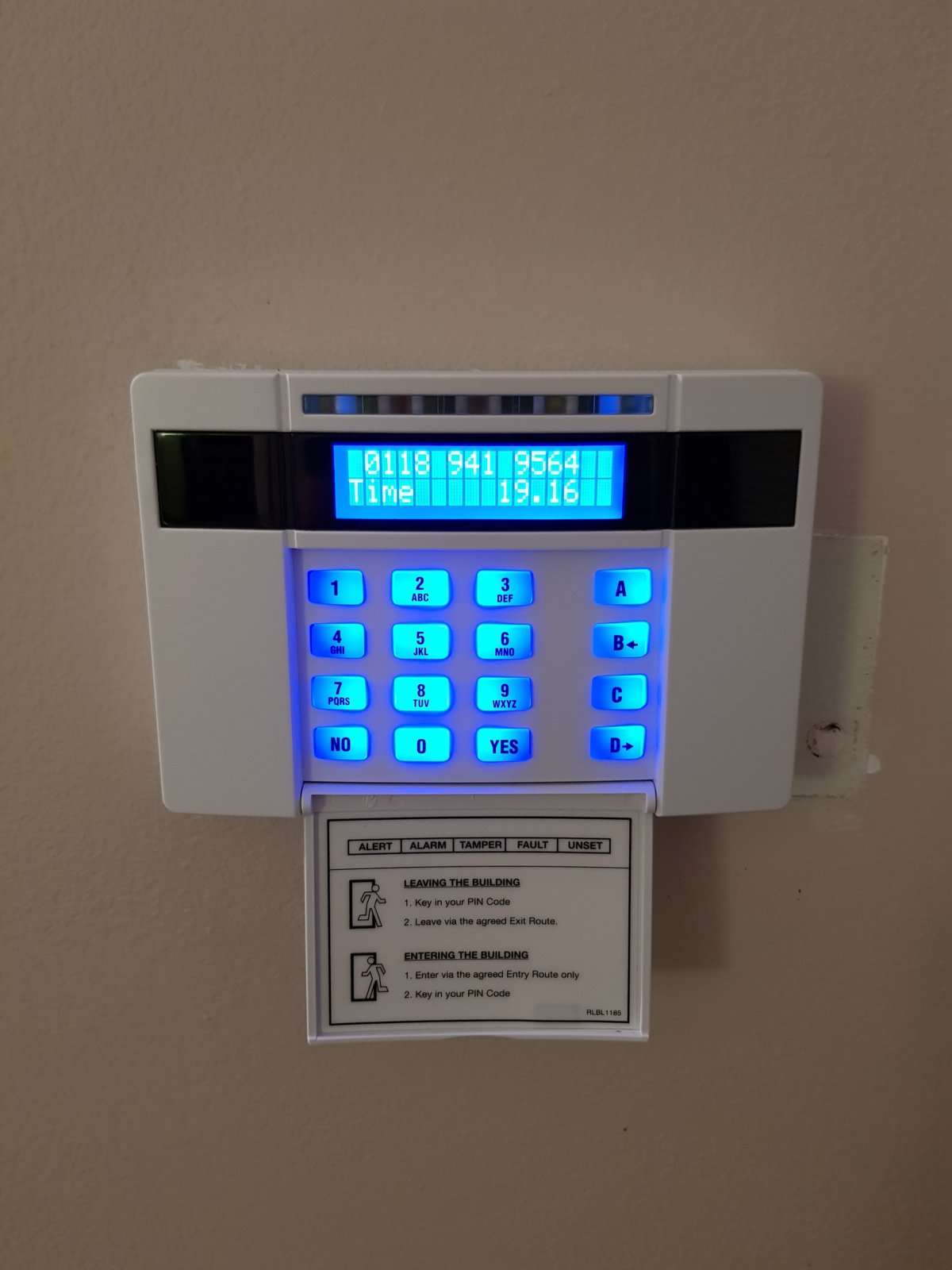

Hi.
Does anyone know how I can programme the inclusion of just 2 areas/sensors, out of a total system of 5, under one of the four alpha codes (I.e. "B") please?
"A" is currently set to all areas but so is "B" and I would like B to be just two areas for, as example, a night setting etc.
What panel is it ? 46 or mini? The normal way is A to all zones B for the zones you WANT on in night set
I don't know which one it is but "B" is definitely currently set to all zones, as well as "A".

Remove B from the zones you want OFF at night. Find out what panel you have by going to software Revision
So sorry, I've lost you.
So currently, when I set the alarm zone "A", it is set to alarm all areas, I.e. hall, kitchen, lounge etc. And I want to remove some of those areas from "B", which is currently set-up to be identical to "A". How can I remove areas from "B"?
'RE the alarm type, I think it's a mini, from the Google search results but how can I confirm it? How do I find software revision?
Go to change inputs, type in the Zone number and press yes to edit the Zone and it will show the areas it’s in AB etc so just press B to add/remove it.
Thanks alarm engineer. I will see if I can find out how to get to that.
Sparkymarka, no, I don't have an engineer code for it.
You can’t, it’s a code set by the installer & it’s unlikely that the installer will give it out. You have two options either contact the installer, pay them to reset the code to 1234 for example. Or default the control panel to factory settings & reprogram the entire system from scratch.
Thank you for the info' and how complex/simple is the latter?
