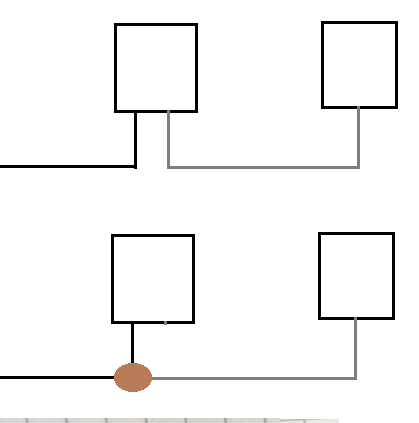

I years gone by it was not un-common to dig one cable from the road & then use it to supply TWO houses by 'looping' the second one from the first.
This looping has to be removed if either party wants an EV charger - a new cable will need to be laid to supply the house which has been unlooped.. My guess is that this is what they are proposing to do.

When I had the loop from my house to nextdoor removed the DNO left my house being fed by the original incoming cable which ran under my driveway and just disconnected the cable running from my house to nextdoor.
I was the first house in the loop so there was no need for a new supply cable for me. Nextdoor had to have a trench dug and a new cable run from the street.
I'm finding they tend to dig a hole and joint the existing cables rather than loop at the cutout

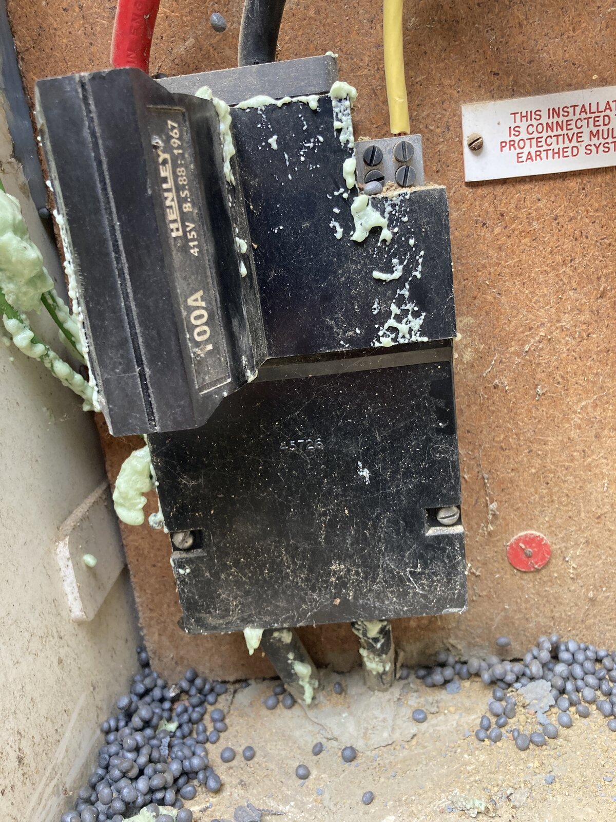

The looped cables cables will be at the supply head, before the service fuse. Not at the consumer unit. You'll see two cables entering the service head at the bottom. See pic below.
The loop is normally carried out like this, although sometimes it is done underground.
