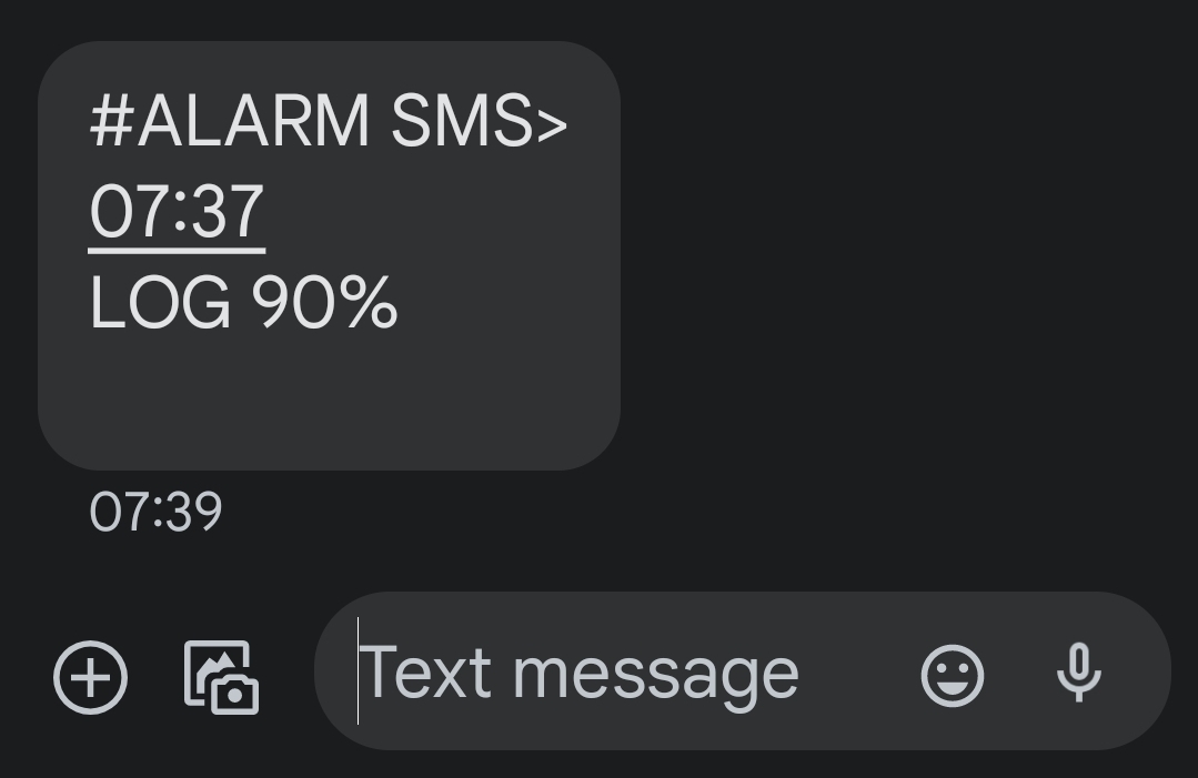

Hi got a galaxy flex 20
Dose enyone know how to clear the event log as mine is showing full

Hi Allen, did you get a reply on this one? I just got the same warning and in the installer manual there are no instructions how to wipe/reset it. If anyone knows if you can do it on RSS maybe, please let me know the steps?
Thanks all!
Sorry just to clarify, I mean erase or delete in full the event log, so it can start filling up from zero again.
So reading further into this, seems the log cannot be cleared (in fact there seems to be some kind of EU rule/regulation that stipulates this). It is probably that it could be used as evidence in a criminal case, hence there is no option for someone to wipe it and in essence destroy evidence. What I believe happens is once the log is full, the panel will overwrite the oldest logged event with the new event, and so on. So there is no need to be concerned about running out of log memory. I assume the panel just warns you at 90% and then possibly 100%, so you are aware the old events are going to start being overwritten and therefore lost.
That's correct. The only way to clear the log on the Flex would be a cold start and reprogram, but as it simply flushes the oldest events, there's no need to do this.
