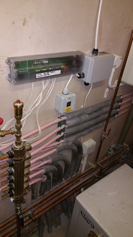

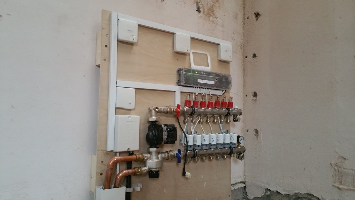

Finished off a load of UFH this week... two Hcc's in one house, and a third along with BDR's and a Bridge in the second with @dean7445 ....
We gotta add some floor sensing to this as the customer wants finer control over the floor temps and won't be persuaded :rolleyes:
Had my first play with a Mains Link too as one of the HCC's was remote to the manifold pump and there was no way to run a cable.
God awful UFH kit already fitted to the place and never worked - Evo to the rescue.
You be careful with your 45 minute programming now though @simond - Uncle Rob will be unhappy with you :D.

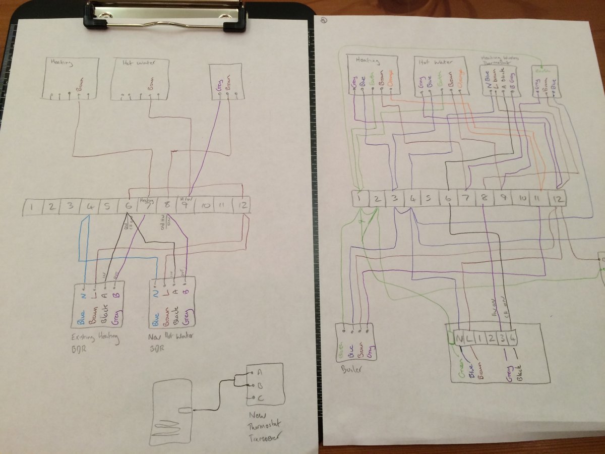

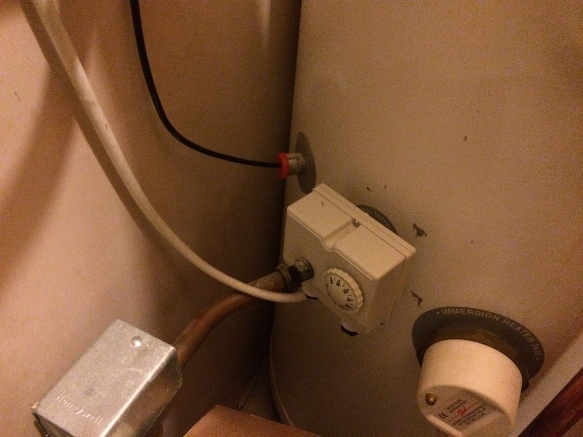

NB: If you have an unvented HW cylinder the thermostat and cut out supplied with this must drop the HW 2 port valve irrespective how you connect Evohome, otherwise you don't have G3/Building Regs compliance.
My unvented hot water cylinder luckily has a second Control Thermostat "hole", so I wired in the existing stat in a series with the evohome stat (see wiring diag above), so that original thermostat has final say on the cylinder temperature. However, even though I've done this it sounds like you're saying I should drop the "2 two port or three port valves" option anyway as per your suggestion above?

he means the 2 port should fail "drop" to safety not leave it out entirely.
