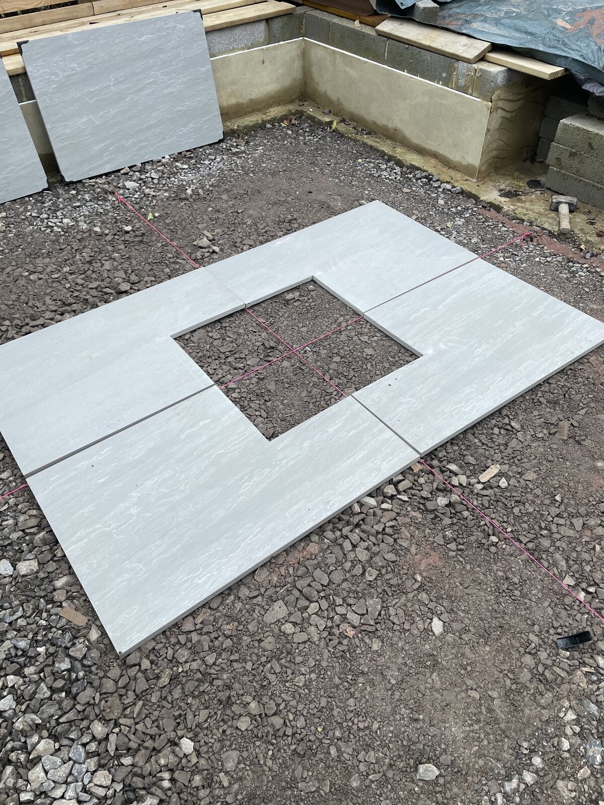

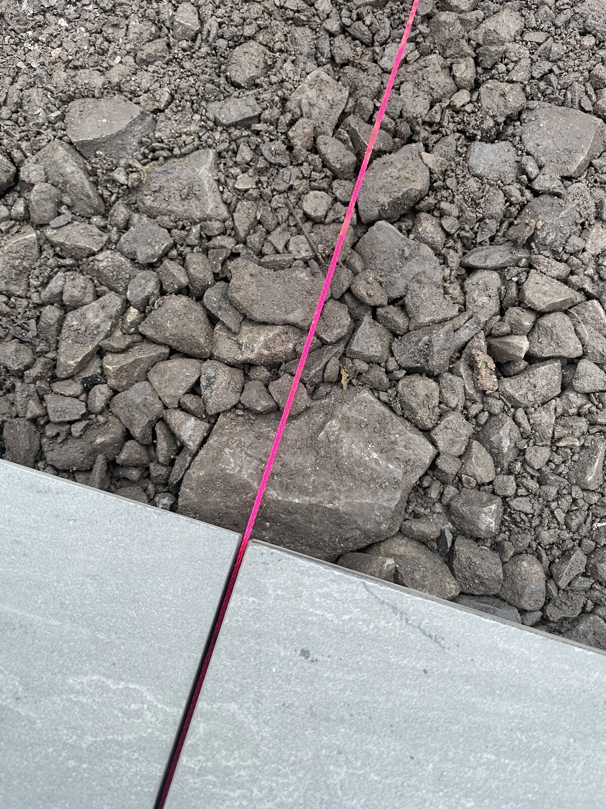

Update.
I decided to go ahead and fit a diamond blade to my table saw and have a go at cutting the slabs. As it happened, one of the slabs was damaged on delivery so I used that as a test piece. It’s not perfect but also not too bad either. There is some small chipping but I I used a grinder to smooth these out. The cut edges will all bordered with stones anyway so shouldn’t really be seen.

Looks good, I think a some small chipping is unavoidable no matter the method. Generally not that noticeable once it's been grouted.
I would have thought stones would cause further chipping or scratches to porcelain, especially if it's a traffic area, although I've only used porcelain wall tiles. Presumably floor slabs are different?
