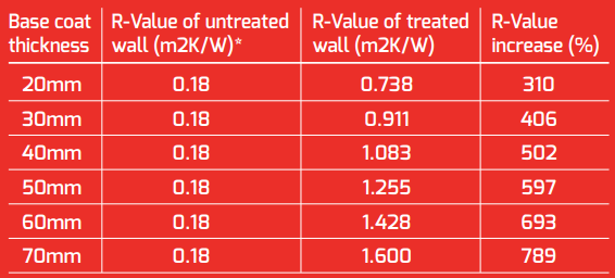

This evening, I discovered thermal render systems from Proofshield, where they claim to have some thermal properties. Just wondered what anyone's thoughts were.
I find getting valid specs hard, as some display U and some R values....

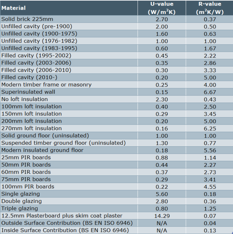

I've attached an image from their PDF, anyone know if these values stack up? I appreciate it won't warm the house like EPS, but it should be cheaper, and my windows won't be tunnelled. 40mm seems a sensible thickness. According to the chart, that's a 500% increase to the R value.

The “untreated wall” numbers that that table look wrong. I’d expect something around 0.5 - 0.6. The benefit of their product looks less impressive in that case….
I find these numbers are easiest to think about if you convert them to Watts and then to £. “X times better” is less meaningful than “Saves £ per year”, right?
Note that PIR is significantly better than EPS.

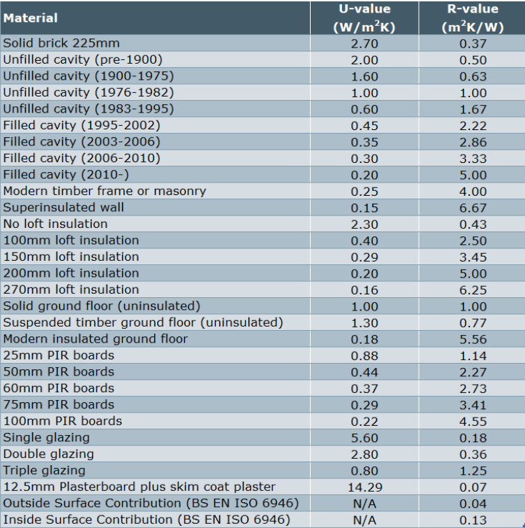

The chart I found here https://www.insulationadvice.co.uk/ti-r-values suggests 0.37, still higher than 0.18.....
It's a decent enough improvement on what we currently have. Does anyone here have any experience with thermal render in general or the Proofshield product mentioned?
