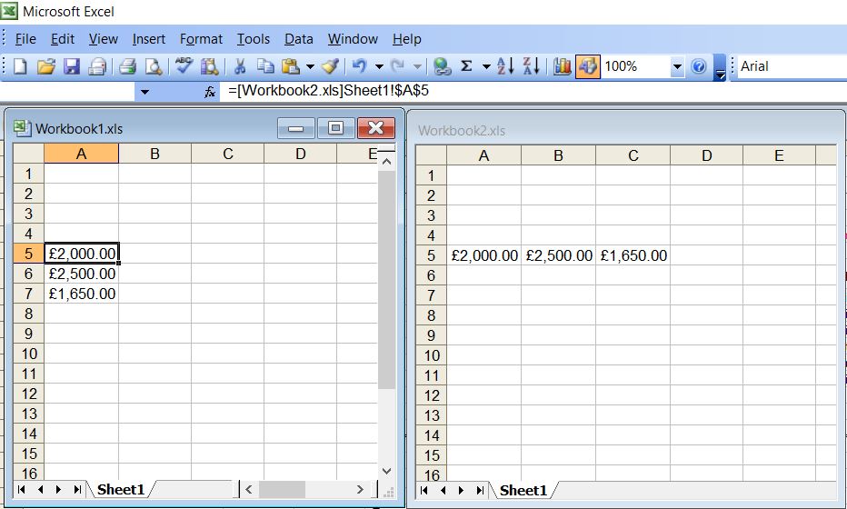

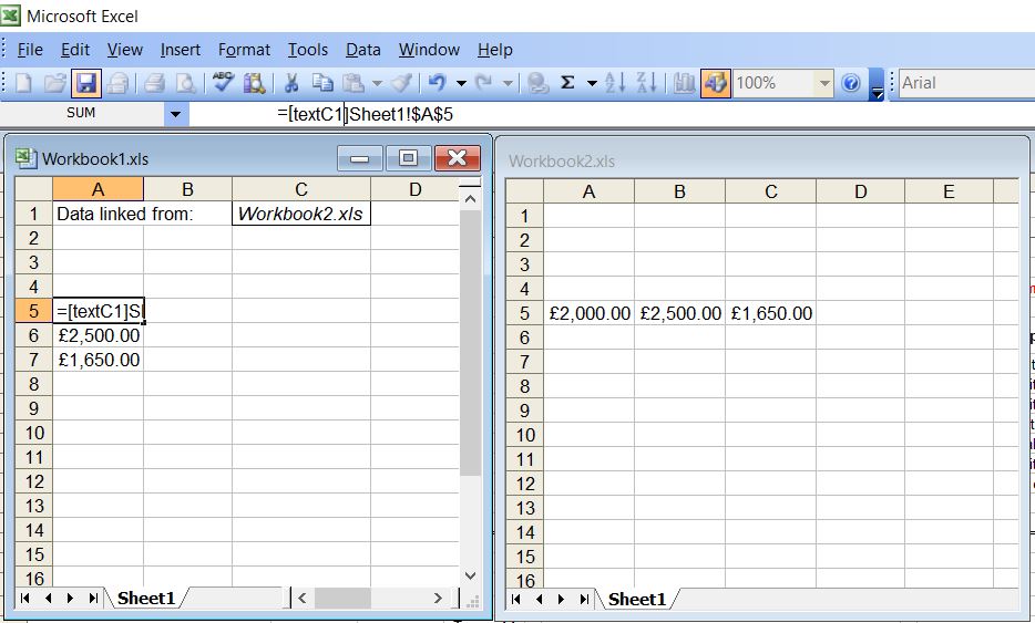

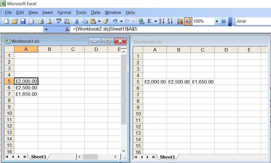

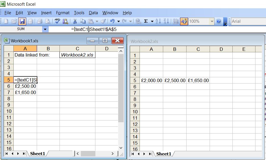

See attached screenshots as examples:
Lets two workbooks; and one sheet in each ie Workbook1.xls sheet1 and Workbook2.xls sheet1
Workbook1 contains 3 cells in column A that are linked across from Workbook2, cells A5, B5 & C5 respectively. The simple link formulae is shown.
What I am trying to do is to input the filename and path of the source document in cell C1 of the workbook1 and for the formulae to automatically use the text of this path/filename within the links. I have typed in the word 'text' but clearly this is not correct.
In these examples I have used just two docs and 3 cells in each. In reality, I have a number of documents with multiple links across.

Use the Excel INDIRECT formula.
In cell A5 of your Workbook1 example above put:
=INDIRECT("["&$C$1&"]Sheet1$A$5")
