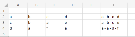

Unless you mean you want to perform a per-row sorting of some other values on the row, into a single cell, like this:
Where the values from columns a to d have been collected into f, in order (but each row requires a different sort order for the cells)
The formula for that above is a bit of a monster but easy to read with multiple lines:
Code:
=CONCATENATE(
INDEX(A2:D2,1,MATCH(SMALL(COUNTIF(A2:D2,"<"&A2:D2),1),COUNTIF(A2:D2,"<"&A2:D2),0))," - ",
INDEX(A2:D2,1,MATCH(SMALL(COUNTIF(A2:D2,"<"&A2:D2),2),COUNTIF(A2:D2,"<"&A2:D2),0))," - ",
INDEX(A2:D2,1,MATCH(SMALL(COUNTIF(A2:D2,"<"&A2:D2),3),COUNTIF(A2:D2,"<"&A2:D2),0))," - ",
INDEX(A2:D2,1,MATCH(SMALL(COUNTIF(A2:D2,"<"&A2:D2),4),COUNTIF(A2:D2,"<"&A2:D2),0))
..and filled down
The 1,2,3,4 in the middle of each INDEX line is what determines twhich term is picked (in essence, sort the cells then pick the first, concat sort the cells, pick the second, concat...)
If your cells aren't in a range like A2:D2 I suggest you create some hidden set of cells somewhere that are that are contiguous and copy the values from your discrete cells. For example if you want to use columns A C E and J in your sorting, make column P a formula of =A1, column Q as =C1, R as =E1 and S as =J1.. This way Px:Rx is the range (paste the formula into notepad and do a find/replace A2:D2 with P2:R2 etc) - this stands a better chance of keeping the formula readable than trying to create a range out of the separate cells in the formula
