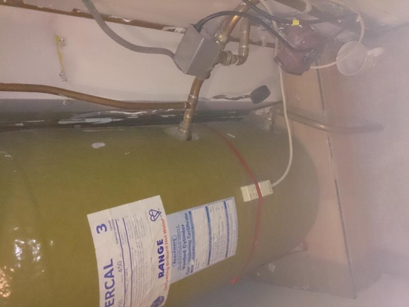

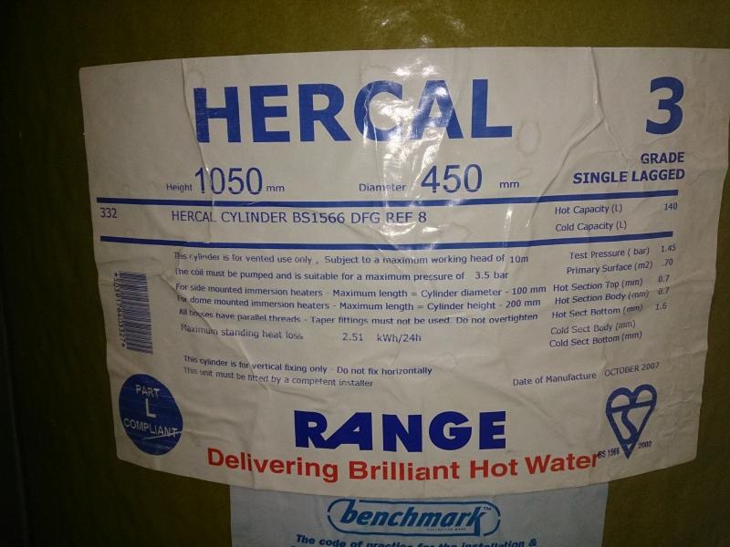

Can you provide info about the cylinder?
Make and model - if label still on/visible?
Age?
Type of insulation?
