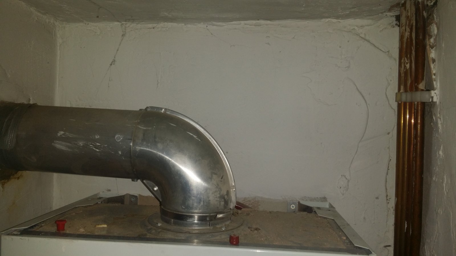

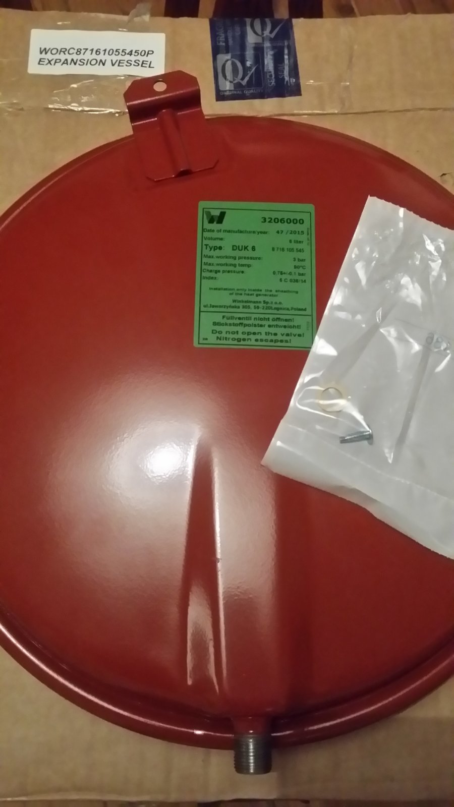

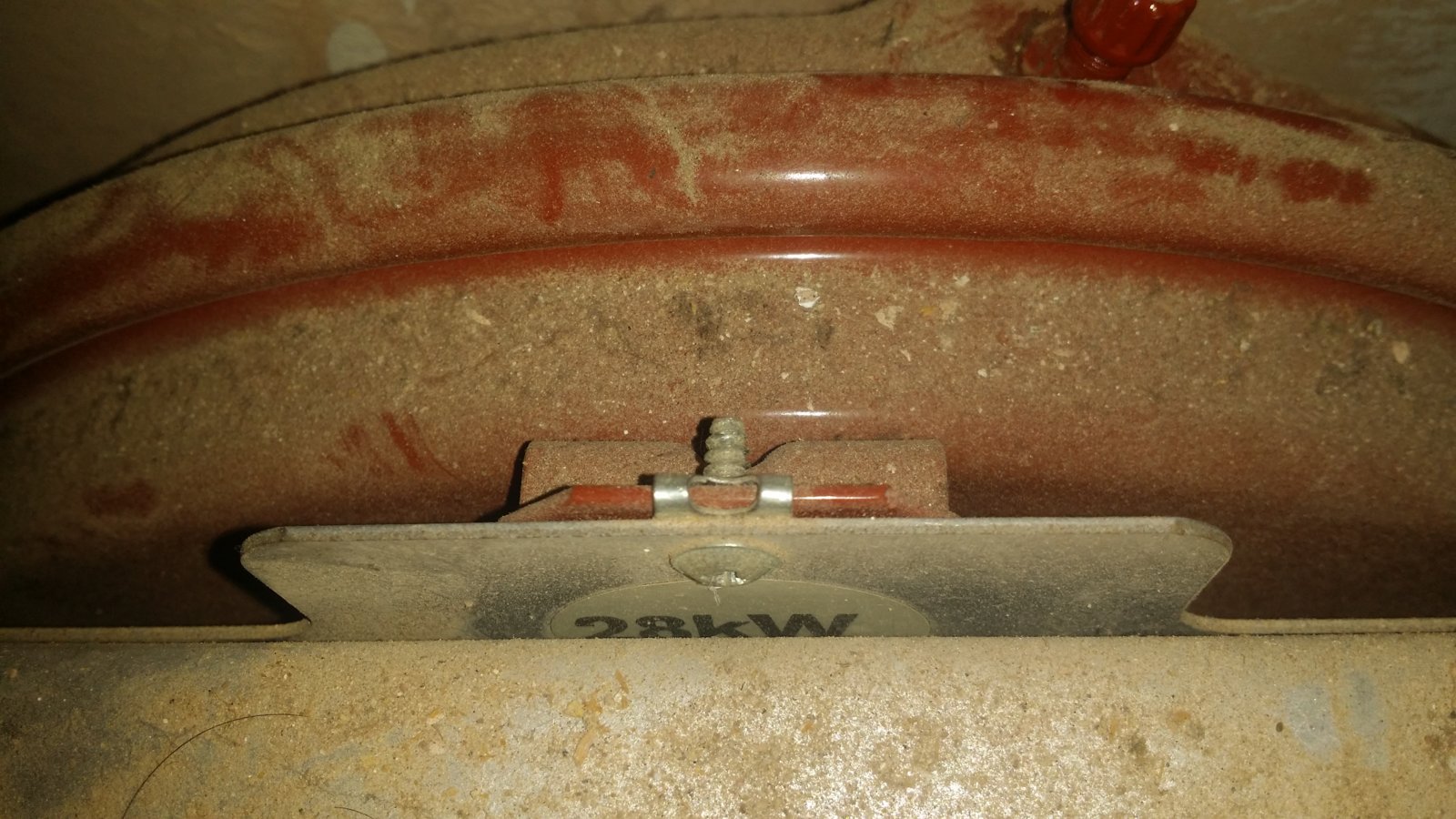

Hi All, does anyone know how long a professional heating engineer/plumber should take to change one if these as the vessel is clearly shot? Water coming out of the shrader valve.
Separately I have found out that occasionally it can be condensation not water and the valve is ok.
Thoughts on both?

from your information provided,your vessel is indeed shot and a replacement is required.
Please consider the work involved to rectify and i estimate at 3.5 hours could be less or £400 cash :idea: (labour only)

If it is just a repair job what's the process for changing the expansion vessel: drain down the system, replace vessel, refill with inhibitor. Done?
still dont know if your expansion vessel needs changing, in my experience about 90% of expansion vessels changed on domestic boilers just needed recharging, on your boiler, if your expansion vessel does actually need replacing just fit an external one it will be a lot cheaper
Ian, if it's bubbling water air side then presumably you should purge it first then recharge?
Any way of telling whether it's water or condensation that's bubbling out.
