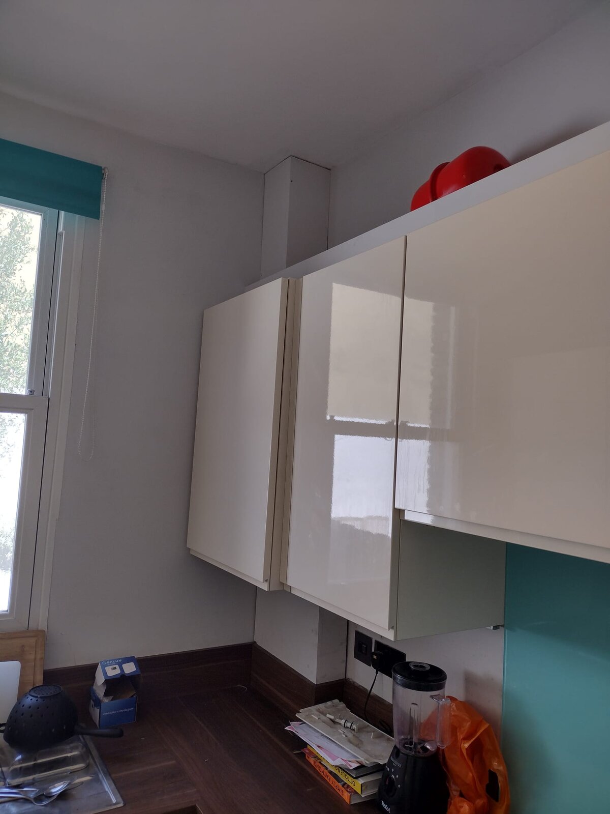

My boiler engineer serviced my boiler yesterday and said that the expansion vessel needed replacing.
He ended up placing it on the cupboards above the boiler....which looks like an odd place to my untrained eye!
I have a couple of questions:
- does the vessel get warm? It is sitting on a wooden/laminated kitchen cupboard
- I feel like it should be boxed in, to prevent anyone bashing it when they put items on the top of the cupboard. Would there be an issue with enclosing the vessel in a wooden box?
Thanks in advance.

:ROFLMAO: , well that's a new look to a kitchen a bright red EV on top of white cupboards!! :cool: Good grief.
I think you need to have a quick word with him, even a grey EV would have looked better or even better find an alternative position for it. What boiler make and model? I presume replacing the internal EV wasn't an option?
Yes they do get warm, but wouldn‘t think an issue boxing in. As per @Madrab make and model of boiler would be handy.

Yes, you can box it in, it will get no hotter than your pipework and radiators, but aesthetically better if the failed one inside the boiler is replaced.

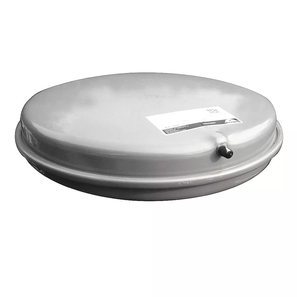

If it's not a huge system and looking at the rough size in the pic, could possibly be around an 8-12Ltr jobby, then one of these for around £55 could have been much better up there.

His first idea was to place it on the work surface :oops:!
I think I will box it in, so it's less conspicuous.
It's a Worcester-Bosch boiler and he said taking replacing the internal EV would take much longer and this was the more cost effective option.

He is a gas qualified engineer....I check his details every year :).
Yes.....aesthetically it isn't great.....it sounds like a box will help. Thanks for the info.
