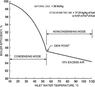

The easiest is the technical stuff. If you can get your boiler condensing more, and cycling less, you might save some money. For it to condense at all, I think the water has to return to the boiler at 54C or less. And the lower it comes back, the more it condenses. So, the lower you set the flow, the more it will condense. Reducing cycling is more difficult to get my head round.

For a condensing boiler to be able to work at it's most efficient, then the Return water temperature needs to be as low as possible, which means flow temperature also needs to be kept low, preferably below 55C.

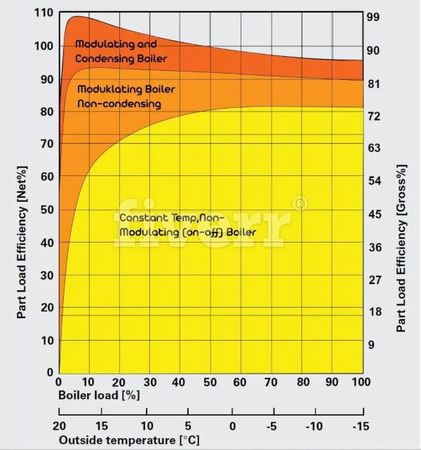

Graph from https://www.heatgeek.com/what-is-boiler-modulation/

Something I forgot is modulation actually saves money. When a boiler is modulating, particularly at 30% and under, it is considerably more efficient than when running flat out.
EDIT: So, if your boiler is running cool, modulating at 25%, and also condensing, you should be able to save 10%+ on it running flat out at a higher flow temperature.
I wouldn't read too much into that graph, there are inaccuracies there or at least omissions. For example, standard efficient boilers are generally much less efficient when modulating (depending on fan control)
And current condensing boilers to the best of my knowledge are not considerably more efficient when they modulate, there will be a slight gain due to the slower flue gas speed allowing more time for condensing to take place, but I've a feeling that graph will be taking into account the lower flow temperature that will be associated with the outside temperature. Flow and return temperature is what will make the most significant difference.

When you burn Methane (Biggest content of Mains Gas) You produce carbon dioxide and water vapour (amongst other things) If you have a boiler running at high temperature, these flue gases including the water vapour leave the flue/chimney and the water will condense giving up its latent heat in the atmosphere.
If you run a condensing boiler correctly (how they were designed to run) then the system water temperature is low, which means the flue gas temperature is low, which means the water vapour condenses inside the boiler giving its latent heat over to the system water before it leaves.
This is the difference between Gross and Net Efficiency of boilers, and why when quoting Net Figures you can have over 100% efficiency on a boiler (which you cant)
The difference in available energy from Methane combustion with and without this additional latent heat of condensing water vapour is 10% so simply running condensing boilers cooler will produce more heat per unit of gas burned than it would if you ran it at higher temperature.

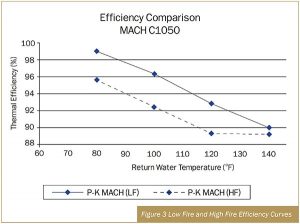

I used the graph because I think it originally came from Viessmann, and I thought it would be reliable. Another graph I found shows a 3-4% efficiency increase with modulation at various return temperatures, which would presumably rule out the cause being lower flow and return temperature. I'm just wanting to understand this stuff!
I've never understood why there are two different x-axis on that graph! Load and outside temperature. I did wonder whether the temperature applied only to the on/off boiler, because I couldn't see how an/off boiler could have a variable load - or maybe it could?
Well on heating the load will reduce fairly proportionally to the outside temperature.
i.e.: at 0°C outside my heatloss could be 10kW, so at 10°C my heatloss would then be 5kW, at 15°C outside id need 2.5kW to keep inside at 20°C
so if I fit a boiler thats 30kW with a minimum modulation of 5kW, it could heat the house without cycling until the outside temp was 10°C, then at 11, 12, 13°C outside and so on, the boiler would have to cycle as it would be putting more heat in that is required
