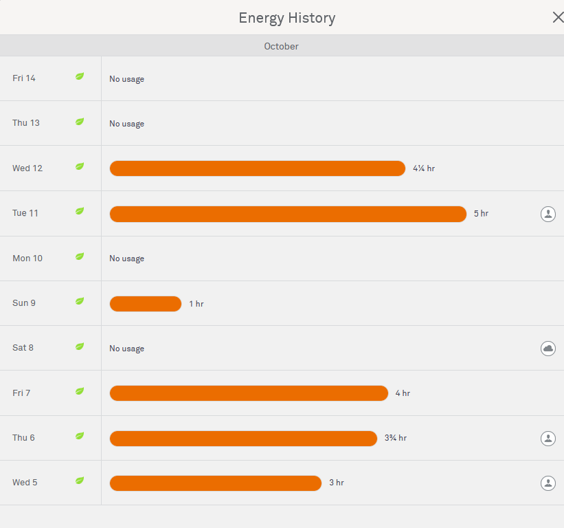

I look at the energy history 1665831712898.png and it shows when the thermostat was calling for heat, not when the boiler was running, so it shows very little as boiler may have been running 100% of the time, but more likely it was cycling and only runs for 10% of times shown, as can't use full 20 kW to heat one room, it will always cycle.
Wow thanks so much for the replies everyone - I don't feel so stupid now because it seems I'm not the only one who finds it complicated. I've got the baby brain going on at the moment, so I'm going to have to read these responses several times for it to sink in and might come back to individual ones, but thanks so much for all the help so far - hopefully its helpful to some others too.

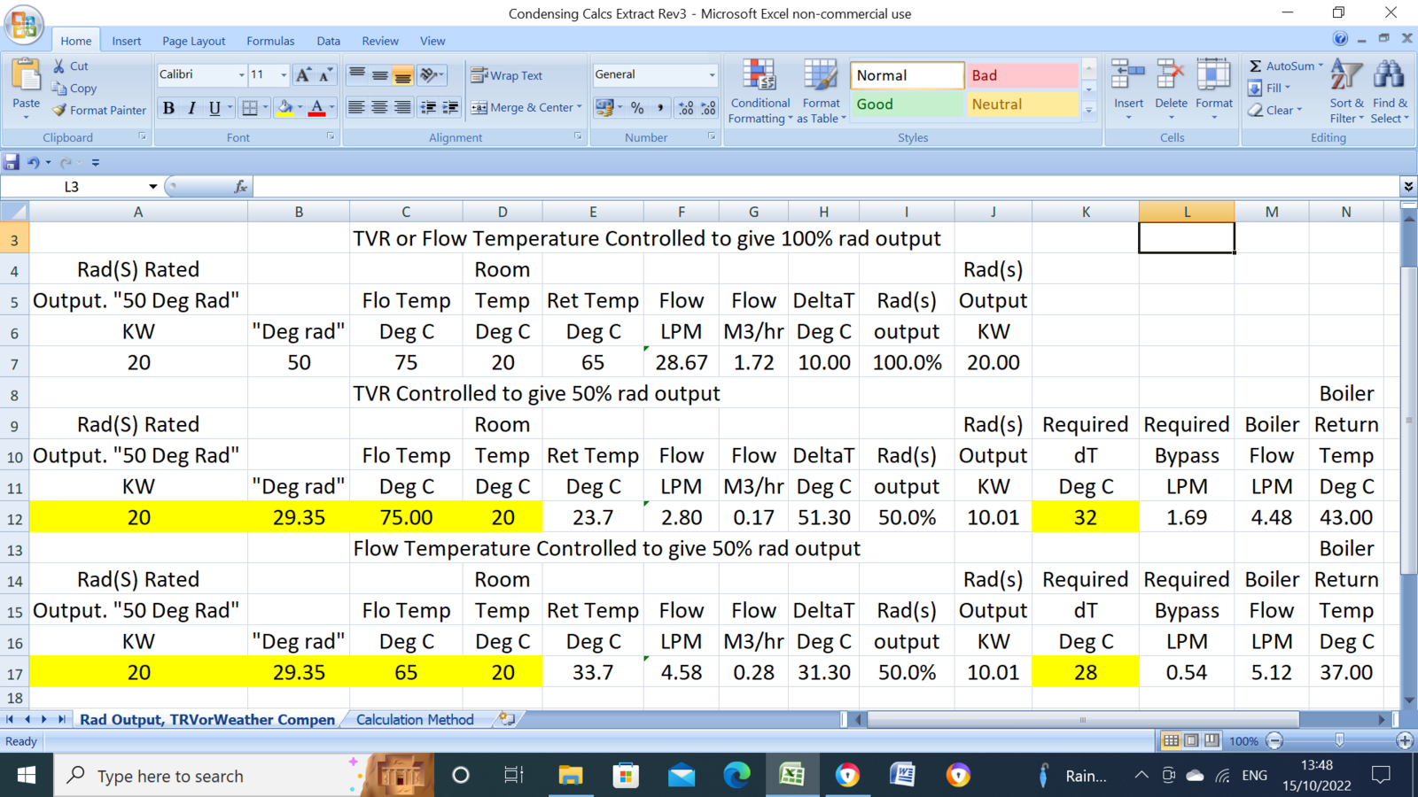

The name of the game in achieving best boiler efficiencies is getting the boiler return temperature as low as possible, TVRs can achieve this with relatively high boiler flow temperatures, Flow temperature Control differently obviously.
I have TVR control on all my rads with a flow temp of 70C and I regularly see return temps down to 40/45C, the challenge for a oil fired condensing boiler (which I don't have) is to maintain the return not lower than 43/45C to avoid corrosion, and with gas boilers its to keep the dT below 30C, in both cases either a LLH or some other means of by pass should be used. If I ever install a HE boiler I am going to install a Tapstat sensing the boiler return temp to automatically control the by pass to give a return of 43/45C.
The attached gives some idea of the various temps and by pass required to keep a oil fired boiler return to ~ 43C and a gas fired to a dT of 28C at a rad demand of 50%.
