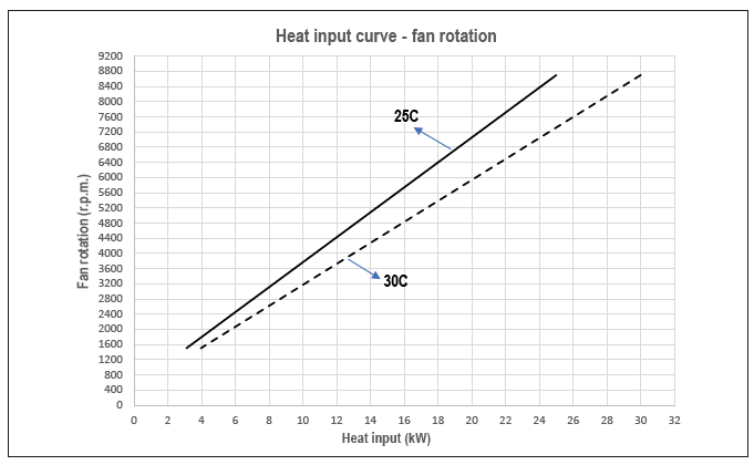

When reading the fan speed, is there an easy way to convert that to output %?
Look at the manufacturers instructions, there's usually a graph or image something like this. Obviously all models will be different. Speed on the Y axis, output on the X axis.
