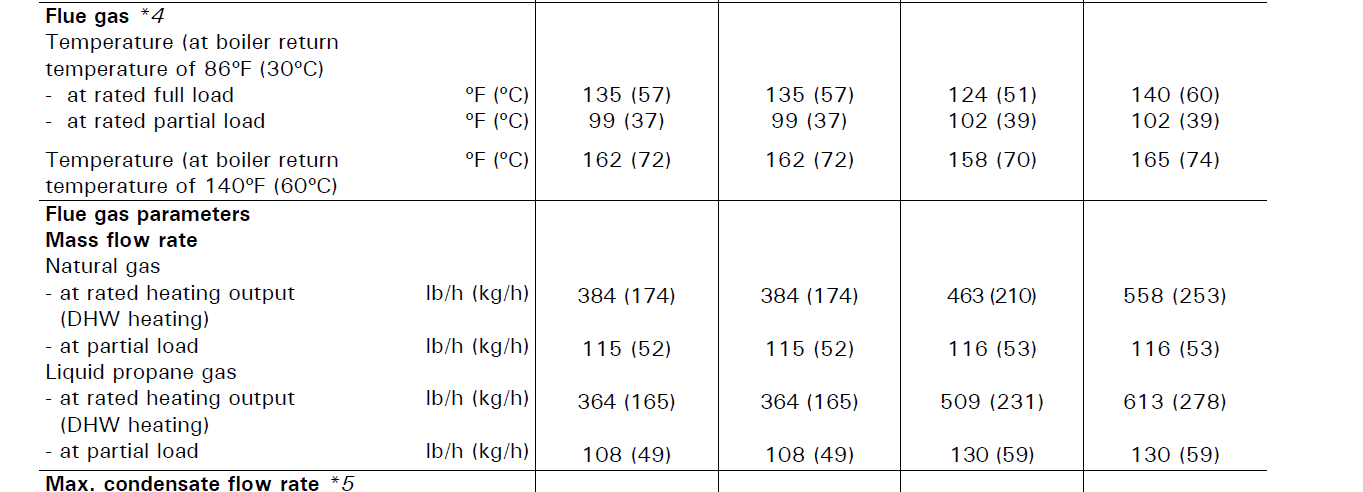

I have seen numbers recently on some gas boiler manual where I think it showed that at full firing, the flue gas temperature was ~ 45/55C higher (its actually only 27C higher) than the return temp and if this is say 35/45C then as some of the gases will be in contact with the combustion chamber then some condensing will take place IMO. On minimum output the gases I think were within 10C (actually 7C) of the return water temperature. It would be well worth for someone with a gas boiler whose interested to actually measure the condensate flow at various boiler outputs and return temperatures.
from page 5 of attachment.
  • Vitodens_200-B2HA_lg_tdm.pdf
Tried that a long while ago on one of ours and metered the gas consumptionn but really only useful on boilers with a separate drain from flue collector and heat exchanger. When combined the condensate will be included from the flue into the hex.

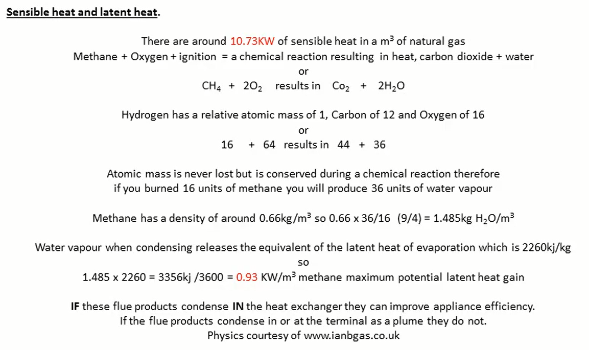

My basic calcs assume the following, that 10% of the fuel input (gas) is the maximum recoverable if fully condensing, the latent heat of steam at atmospheric pressure is 2256kj/kg, call it 2256kj/litre or 0.627kw/litre, so max condensing per kw of gas burned is 1X10%/0.627, 0.16litres/kw. So a boiler running at a output of 30kw, say 31kw fuel input fully condensing should produce 0.16X31, 4.96 litres of condensate/hour??, it will obviously less in practise. If condensate flow is ~ 2.7 LPH then gaining 5% due to condensing gain.

Your calcs above show a max latent heat recovery of 0.93kw/M3 or 0.93kw/10.73kw. this is only 8.7%, looking at typical nat gas analysis (UK), LHV & HHV thought it worked out almost up to 11% wet gas loss.

A fairly simple method (assuming no condensing) is to use a loss of 0.45% per 10deg flue gas temperature so a boiler with a flue gas temperature of say 60C would have a sensible heat loss, assuming combustion air at 20C, of 0.45X(60-20)/10 or 1.8%, add the 11% wet gas (condensing) loss so a total loss of approx 12.8% giving a boiler efficiency of 87.2%?.
