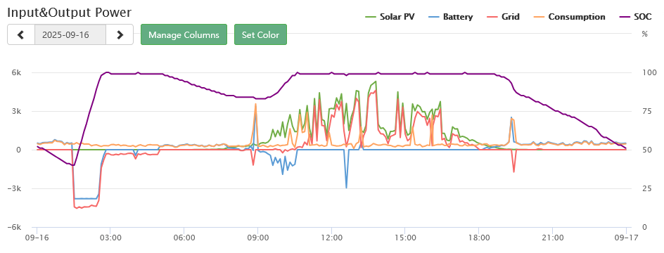

But this may tip the balance for some tariffs. My inverter, as far as I can see, can't be programmed to have x kWh left in battery at 4 pm, and I would need that to ensure I have enough power to so not using grid power until 7 pm at the earliest. So Agile is for me taking a chance on what the weather will be like. To be sure I will not run out of battery before 7 pm, I would need a third or maybe fourth battery, at over £1000 each, not really worth it.

I started with 3.2 kWh, and then doubled up and now have 6.4 kWh, I use around 12 kWh so in summer with 6 kW of panels I am normally OK, what I found was a problem is the battery would only charge at 2 kW so with a 5 kW inverter I was seeing export even when battery not fully charged, and it would discharge at 3 kW so also importing when loads of battery left. So doubling up made sense, but now to spend £1000 to move off-peak to peak time, I think around 10 years at least before it is paid off, so not really worth getting an extra battery. Specially as we have no idea what changes to electric charges there will be in the future.
you mean when the sun is out and you get 6kw from the panels, 5kwh go to battery and 1kwh exported (/lost in your first 20 months)? Then a larger battery would not change anything. My inverter is only 3.6kw, which is annoying as in the evening I could be forced to draw from grid even though I have plenty of capacity in batteries. In hindsight, should've pressed the installer for a larger one with an export limiter so the G98 is ok...
But that should not be the case with a 5kw inverter no?
Maybe it's settings? I find "Energy Stats" allows you to customise/check easiliy.
The 6 kW solar panels rarely can produce 6 kW, so the 5 kW inverter means on the odd time it can produce 6 kW all over 5 kW is lost. In the main we use less than a kW, so the extra 4 kW will now go to charge the batteries, but before the second battery only 2 kW went to charge batteries as that's the batteries limit, if using no power in the house then 4 kW to batteries and 1 kW export, but that situation is rare.
