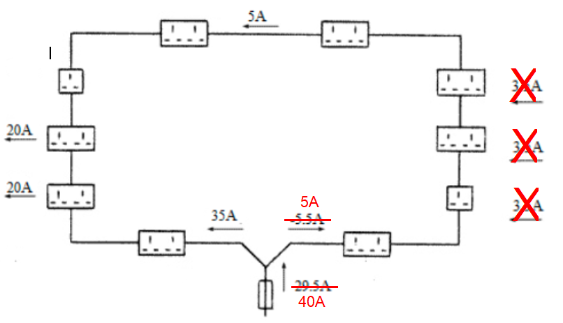

Cannot "a problem similar to what is shown" not equally possibly arise even if there are NO 'plugged-in' solar panels, the possibility of cable of one leg of the ring being 'overloaded'depending only upon the magnitude of the loads and how close they are applied to an end of the ring (e.g. 40A worth of loads applied close to one end of the ring in your diagram) ? ....I have looked at our ring final <diagram> and what could happen, remember some homes only have one ring final, but with the old BS546 15 amp socket, we would have multi-circuits and still likely 20 amp cable, with 15 amp fuse, so what is shown is unlikely to cause a problem simular to what is shown, the same applies with continental system, it could still happen, but less likely.
We have to use the ratings of the protective device, yes I know we can draw more than 32 amp from a 32 amp RCBO, but not for an extended time. So with 40 amps the RCBO should in fullness of time trip. Fullness of time meaning before the cable overheats.Cannot "a problem similar to what is shown" not equally possibly arise even if there are NO 'plugged-in' solar panels,

What do you mean by "we have to use"? I was merely illustrating what the situation would be if, with the arrangement you illustrated, one simply removed ('unplugged') the three plug-in solar panels.We have to use the ratings of the protective device, yes I know we can draw more than 32 amp from a 32 amp RCBO, but not for an extended time. So with 40 amps the RCBO should in fullness of time trip. Fullness of time meaning before the cable overheats.
As you have written it, that it surely makes no sense, does it? Whether or not loads could, in some circumstances, 'overload' some of the cable of the ring depends on the locations of sockets within the ring - and if the locations are such that that is possible, then it is surely 'portable' (not 'non-portable') that would present the risk, isn't it?There is a problem with the ring final in that high loads near to origin can overload the cable, which is why it says non-portable equipment over 2 kW should have a dedicated circuit.
Idea is portable uses power for less time, and to overheat needs time.then it is surely 'portable' (not 'non-portable') that would present the risk, isn't it?
