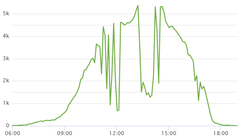

The 800 watt limit, and how much that will help, is the main question. My solar yesterday
so I need the battery to cover from 05:30 to 08:00 and 16:50 until 00:30 next day. So approx 7.5 hours in the evening, so around 6 kWh if drawing 800 watt for the whole of the time, I have some heavy usage for first hour, but that is over the 800 watt, so average more like 500 watt, so need around 4 kWh to see me until off-peak starts if maximum draw is 800 watt. This assumes battery fully charged at 4 pm.
Yesterday produced 24.4 kWh of solar, with 6 kW panels, so adds seem to show around 750 W for balcony solar, so 24.4/6000x750 = 3 kWh so 12 kWh my daily use, minus 3 = 9 kWh of which 4 at 8.5p/kWh and 5 at 32p/kWh so £1.94 and without any battery or solar, 12 x 25p/kWh = £3 so £1.06 reduction lets call it £1 a day saving so saving £365 per year. Allowing for bad days, I would think £250 a year is more realistic. With 750 watt panels we can assume no export, it would have a job recharging the battery never mind export.
