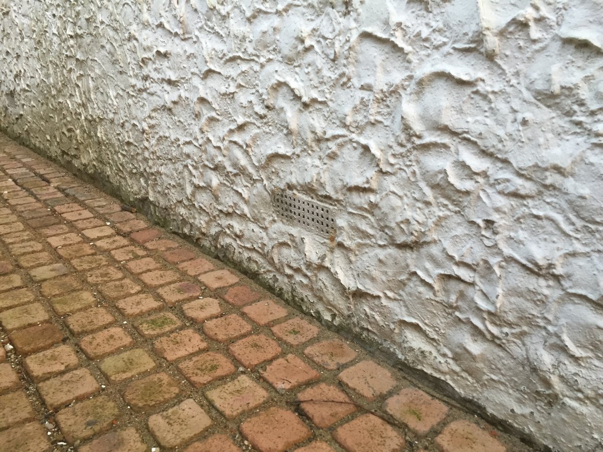

This is the side of the house
Assuming the DPC is directly under the air brick, do they want that exposed from there down to ground level? Or 75 to 100mm above the DPC exposed and then fully down to ground level?
I will contact them, but they're not avaiLable again until Monday!
Usually you hack off 150mm below the DPC to the ground. The Dpc should be in the bed immediately below the air brick but thats not always the case.
Rear elevation OK -
Just needs render removed, is he talking about below the Dpc or removing all the render?
For the time being why not just remove the 150mm below the Dpc?
This entire proposed enterprise is wide open to interpretation? and fraught with a probable on-going argument?
The shall I call it wording of the request from the Cavity Wall insulation installer is bluntly Crap!
As an aside what if there is no DPC? or the DPC position cannot be determined, or as I see regularly the DPC steps up and down even on a level to the ground wall?
There is another as I see it, problem that being if you cut the existing external render, there will be spalling and break out above the cut line? excess vibration could cause the remaining render to De-bond?
How will the cut lower edge of the remaining render be made water tight, any thoughts on a drip, and how to form it? so that rain water on the external surface of the render drips off and does not run on to the top of the DPC.
