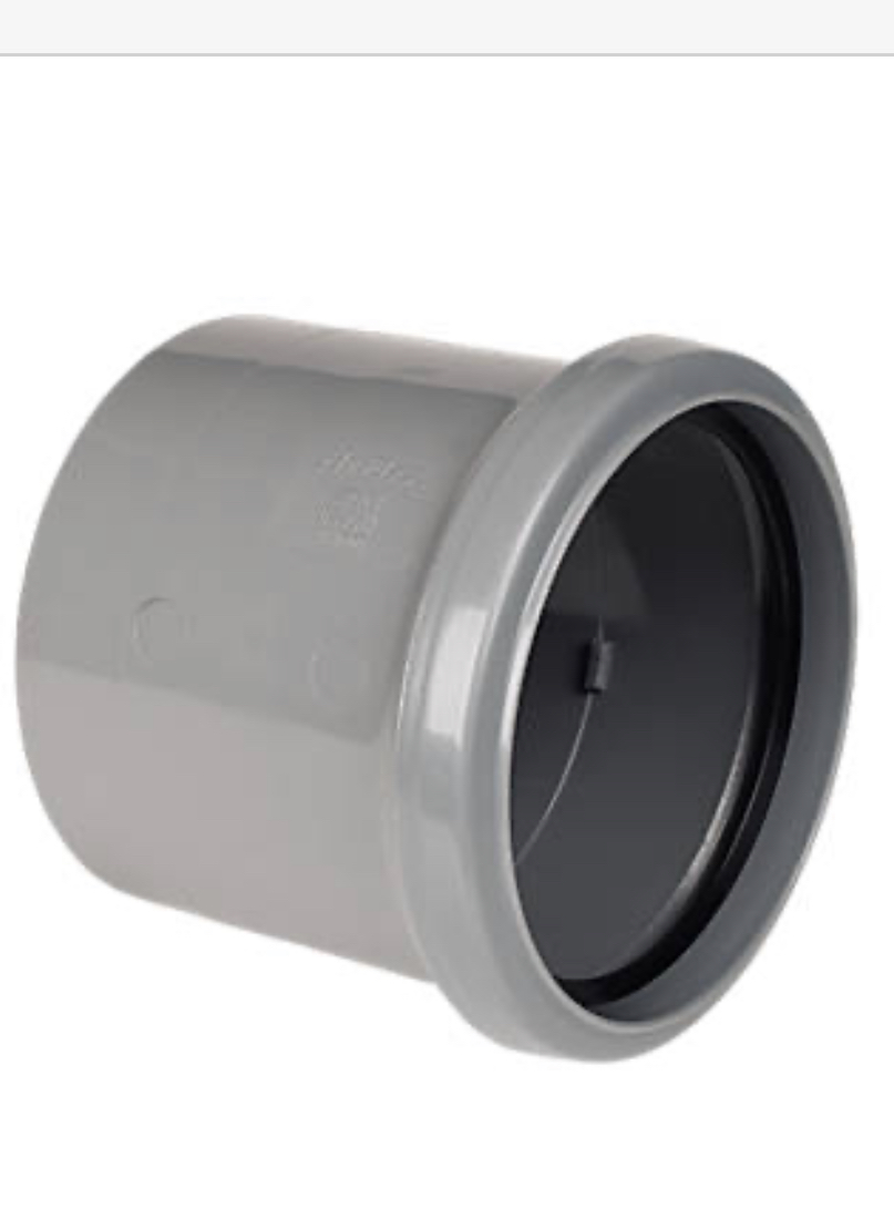

    I'm adding a shower to my bathroom to the left of where the soil pipe bends for the toilet. A toilet will be fitted back in it's original place. I need to keep the 40mm shower waste below floor level so using a branch vertically isn't an option.
    Would something like the following be ok? Use a branch on it's side with a 40mm solvent weld boss adaptor in the end?
    Just checking this kind of thing is ok, especially being used horizontally. Or are there any other better options? If the branch is the way to go want angle should I go for?
    Thanks in advance on any advice!

    It's not ideal but if needs must then you can. Use solvent welded fitting as you mentioned, last thing you want is the pipework coming apart. Try and get the shower connection in as high as possible to avoid any possible backing up of the soil causing an issue with the shower waste.
    If you remove the existing bend, I wouldn't rely on reusing the seal in the 110mm pipe, (it'll have shrunk and wont seal again), so you'll need to cut back the 110mm, (chamfer the end) and fit a coupler, new section of 110mm, then your junction.

    You could try putting a branch into that existing socket and testing it with buckets of water till your satisfied it’s leak free..however incase the existing socket doesn’t seal when you take out the bend and put in a branch I would cut the pipe back a bit and glue on a loose collar and start from there (although it would move your toilet waste a couple inches) If the toilet waste has to be EXACTLY where it currently is I would cut the existing waste back - glue on a collar - put a bit of pipe with your branch in so it lands where you want it..then the glued boss you suggested and run off in 40mm for the shower. Below is the loose collar I am referring to. Good luck pal!

    It was meant as advice rather than trying to be cocky. If you can get hold of a small mirror that helps to see the underside of the pipe, rather than working blind. I am more concerned to be honest about you attempting to replace the ring seal in the existing pipe, but having said that, you appear to have a moulded socket there rather than the type where the seal is placed on the end of the socket and the 'lip' is than snapped on to hold the seal in place.
    Having fought a losing battle with the latter type on several occasions before, I wouldnt want to risk it under a bathroom floor!

    Ultimately the ring seal end could be cut clean and square from the inside using a dremel with a cutting blade, or using a wire saw, then a piece of 80grit to debur/round out the end, then use a double socket solvent coupler. Apply the cement on the inside of the socket rather than on the cut male end of the pipe (not ideal I know) but the excess glue that would be pushed up into the pipe could easily be cleaned from the inside to ensure there's no build up. If it's twisted as it's fitted then I am sure that coverage would be more than enough to make a sound joint.
    The other pieces (Toilet branch and solvent waste adapter) could be built up prior to it being added to the main pipe and new solvent socket so would then be easy to glue and push into place.
