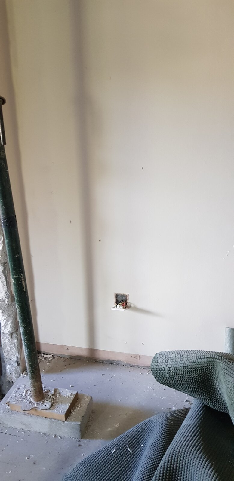

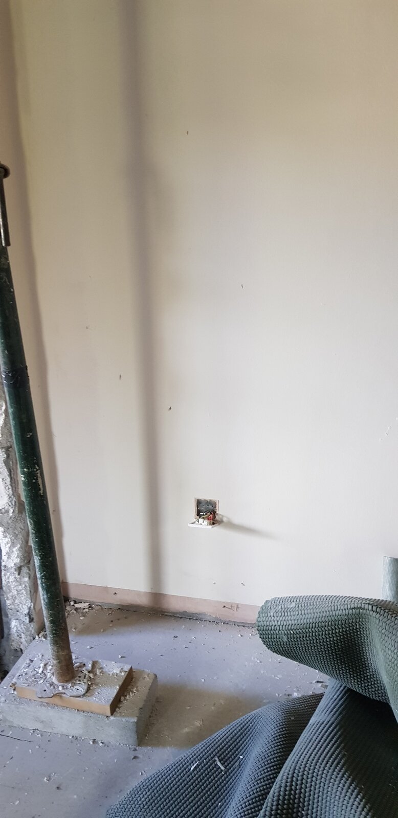

Hi guys
Just after some info concerning extending my ring main. Got all the planning application in and it will all be signed off - I want to extend the ring main into my extension all the current sockets are fed from under the floorboards so not just a question of adding some junction boxes and extending that way.
My thought is I have a socket which is the closest and access underneath while the ceiling is down. My thoughts are to pull those 2 cables back and join the new cable using a wago chase the top of the socket and run the new cable up into the loft around and down to feed the new sockets and then back to the original socket as above joining to the other cable again with a wago.
My question is, is this is the best way? And am I ok to use one of these cables to feed the socket here and effectively having tge other just passing through so to speak?
Excuse the crappy picture

Hi guys

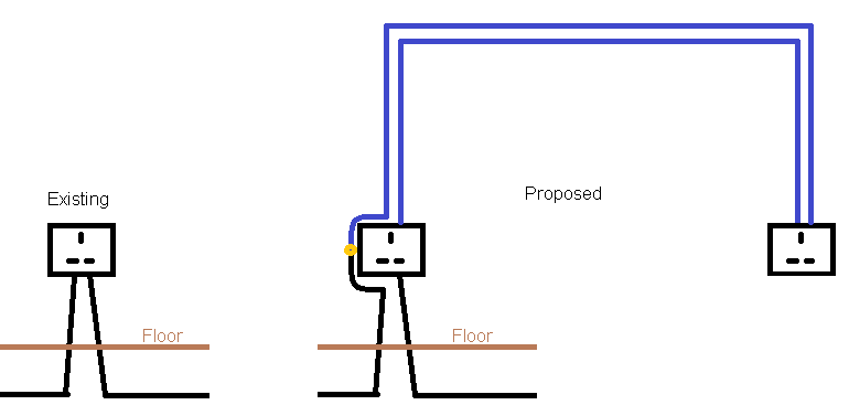

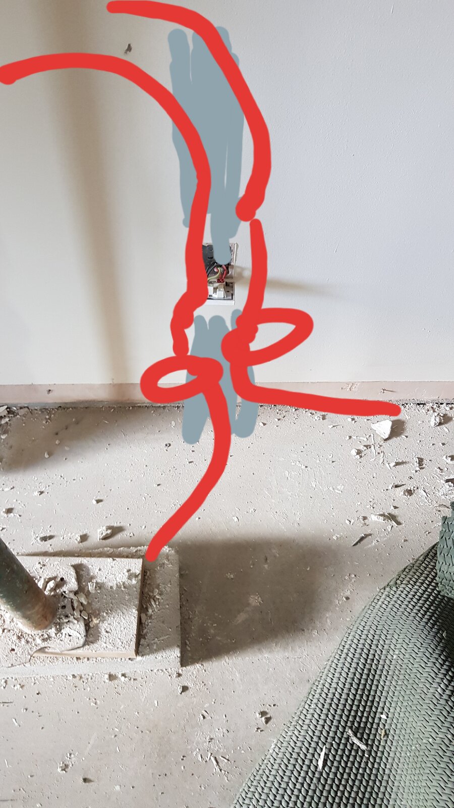

Assuming the existing socket is on a ring circuit an idea is to join one of the new cables to one of the existing to extend the ring. I've shown it as looped round the outside of the existing socket but in reality the join (wagos?) should be within the backbox. If there isn't space I'd consider changing the existing socket and backbox to a double.
The person signing to say he has designed, installed and inspected is the person to verify it is a ring and whether the existing circuit is suitable for so much additional cable etc.
Step one is look at the original installation certificate or measure R1 + R2 or at least the prospective short circuit current or loop impedance and work out if extra cable can be added to the ring final. 106 meters is considered to be maximum length to comply with volt drop, but also depends on the over current device, for example a B32 MCB will trip on the magnetic part of the trip with 5 times rated valve, so 160 amp, using ohms law, this equals approx 1.44Ω and add 5% for safety, 1.36Ω so step one is be enquiry (reading installation certificate) or by testing, (using the loop impedance meter or low ohm meter) work out if you can add to the ring final.

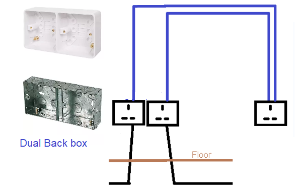

Using a twin back box and two single sockets, or a double back box and two grid sockets, is likely the easiest way to split the ring. To add to the circuit the circuit will need to be RCD protected, and I think the new edition is now in force, so will need to be a type A, can't use type AC any more.

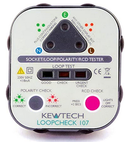

Unfortunately the cheap plug in devices
seem to be designed for radial circuits, the pass mark is based on a 20 amp B type MCB, at around 1.9Ω depending on the make, so to work on a ring final the test equipment jumps from around £40 to £200, although since we really want to work out what the earth loop impedance will be after the extension is fitted, we really want to be reading down to 2 decimal places, so we know what can be added.

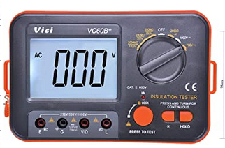

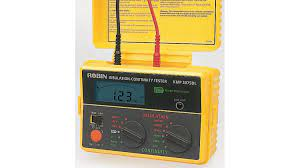

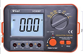

The cheap (£32) insulation tester
has no low ohm range, to get a low ohmmeter with the required 200 mA test current is expensive. Lucky I have one, but again looking at £200 mark to buy one.

Unfortunately the cheap plug in devices View attachment 276138seem to be designed for radial circuits, the pass mark is based on a 20 amp B type MCB, at around 1.9Ω depending on the make, so to work on a ring final the test equipment jumps from around £40 to £200, although since we really want to work out what the earth loop impedance will be after the extension is fitted, we really want to be reading down to 2 decimal places, so we know what can be added.
The cheap (£32) insulation tester View attachment 276139has no low ohm range, to get a low ohmmeter with the required 200 mA test current is expensive. Lucky I have one, but again looking at £200 mark to buy one.

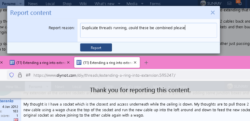

Yes done the same myself, the problem is when you don't realise two are running, so miss half the answers, is there a way to get sysop to combine them?
have you reported it yet?
Is this not one of those things which you do if you think it needs doing?
There you go, I've done it for you.
