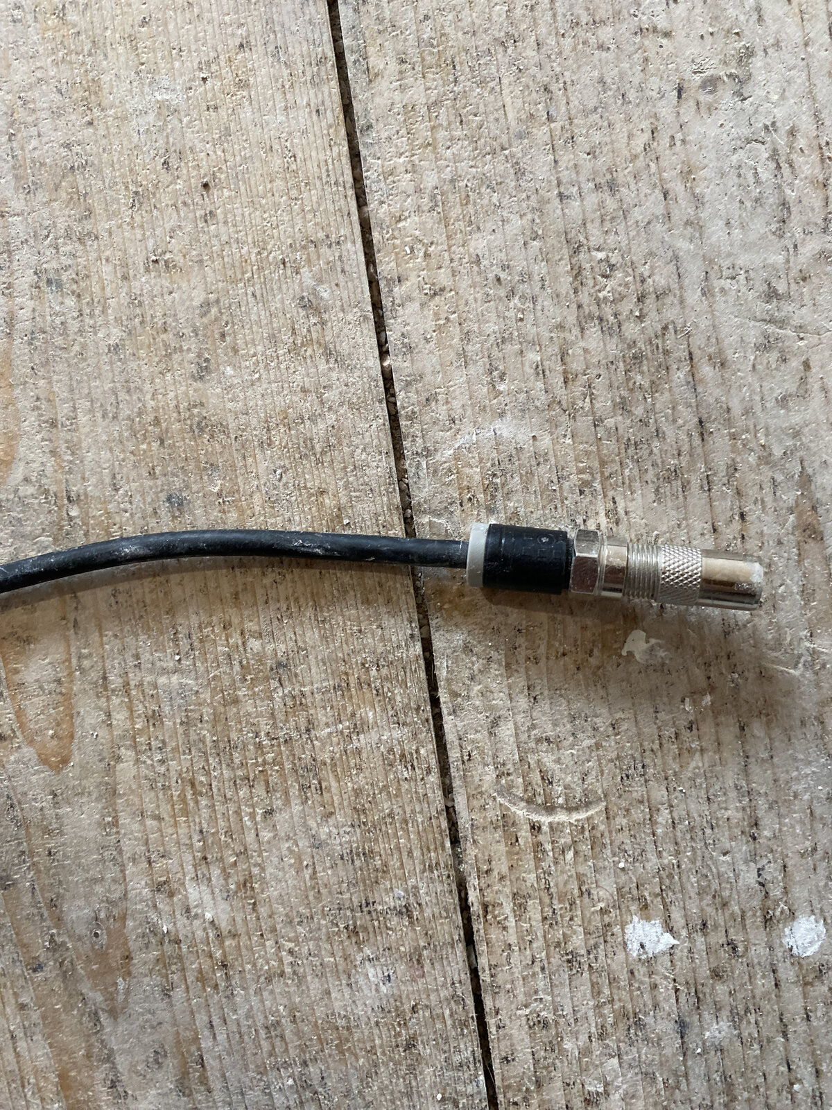

Hello
I wish to extend an aerial cable in my bedroom as I’m moving the TV to a different position. I will be lifting the floor boards and extending it under them. What’s the best way to do this as once the floor goes back down I won’t have any access to the join if something goes wrong. I’ve attached a pic of the end of the cable which seems very thin.
Thanks for your help.

the good news is that your existing cable has an f connector on the end of the cable. it also has an adpter that goes from f connector to coax. so to join another length of cable to it you will need a joiner like this
https://www.ebay.co.uk/itm/124609358925?hash=item1d034bec4d:g:6OAAAOSw2XJgP8T7 and two f connectors like this
https://www.ebay.co.uk/itm/254471156317?hash=item3b3fa9b25d:g:tfQAAOSw96leD8BS
unscrew the adapter ( the bit on the right) from the f connector and screw in the joiner, on one end of the new cable fit one of the new f connectors then screw that to the joiner, tighten up the nut like bits with a small spanner (11mm) till it is not loose or liable to come loose. you can also cover the join with heatshrink sleeving if you wish to isolate the metal and to ensure that the nuts dont come loose. then fit the other new f connector on the other end of the new cable and fit the old coax adapter to the f connector and plug the new cable in to the tv to test before you put the floorboards back down!

Thanks Suritsoff. What size co ax cable do you recommend for the extension?
If you know the length of cable you need, I can supply you a full kit using Webro WF100 coax (white or black) - all copper; the best coax you can get without going stupid daft OTT - fitted with a compression connector including O-ring moisture gasket, an F-type back-to-back joiner and double layers of heat shrink tubing for extra peace of mind.
