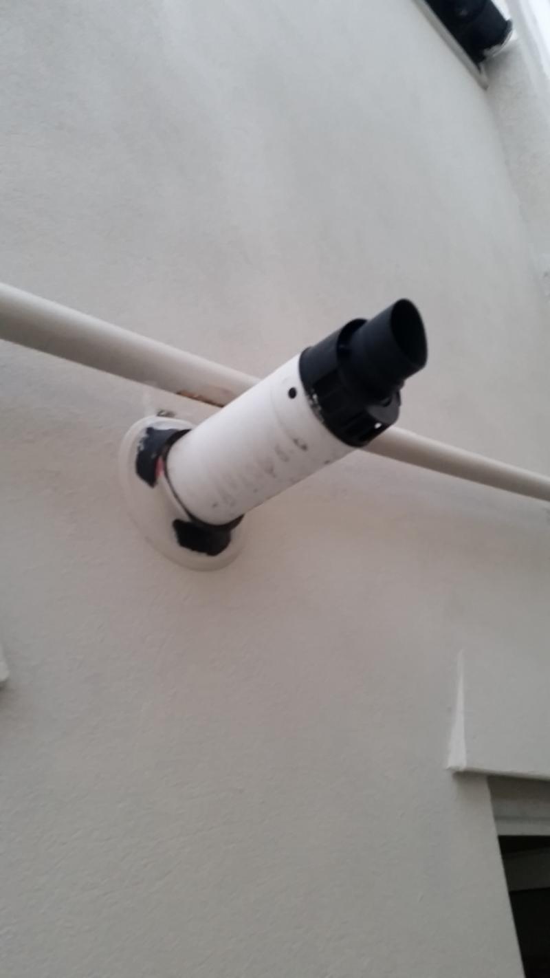

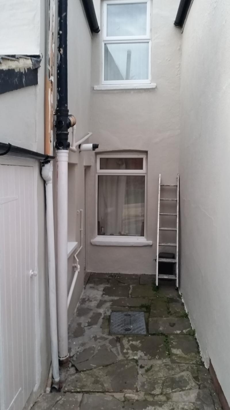

A picture tells a thousand words, so these would explain what I'm looking to do/solve.
Basically I want to put a simple perspex (or such) roof over the back door and windows, to have a few metres of dry area, it wont be closed in, so just a shelter really.
...but I have a boiler flue in the way, which will just steam up and rot wood, etc, as well as look pretty stupid.
I'm trying to find the right kind of kit to extend the flu either straight upwards and through a roof, or coming horizontally away from the door to come out underneath the roof.

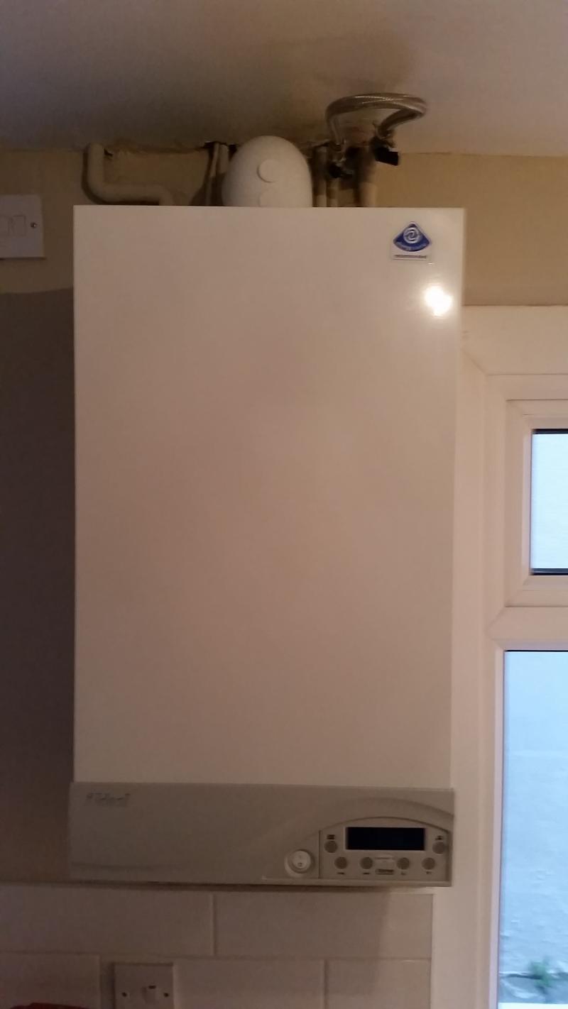

Moving the boiler isn't really an option due to cost and it already being in the best spot it could be (although I'm now wondering if I could/should have had it fitted in the above bathroom where the old tank was :/ )

roof would go in here somewhere...
flue (it is angled)
Ideal boiler...
You will be looking at boiler relocation - it is not acceptable to simply fit a plume management kit as the air intake and POC outlet would be in different pressure zones YOU MUST CONSULT A REGISTERED GAS ENGINEER before going any further with your plans ;)
Oh dear, really?
I thought it'd just be more a case of it being away from the windows and such. So I guess a straight 90 degree upwards turn is no good? That seemed to be a solution on another thread about flues I found on here.
Fair enough tho. That sounds expensive so I'll likely leave it till next year and crack on with sorting the crazy paving instead.
I suspect the flue bits to do as you want are available, however, whether the manufacturer would approve of it being outdoors is another matter.
Some manufacturers will allow a pmk to be used in this situation. Worcester certainly do.
The inlet and outlet will still be in the same pressure zone, that only relates to differnt sides of a building. Ie you can't take air from the east side and terminate on the west side.
Best advice would be to contact a registered gas fitter and get a few ideas.
Hmm, maybe I'll call the guy that fitted it. His yts kid didn't do a clever job on the rad piping due to rushing it, but they did the lot in a day and boilers been fine for a few years...

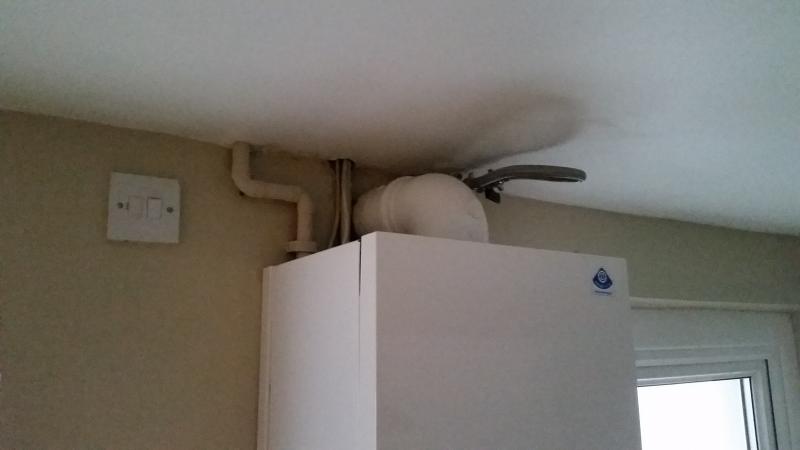

They can cut the flue to the correct length whilst they are there too.
The black terminal should be flush to the wall with the white section in the wall.
